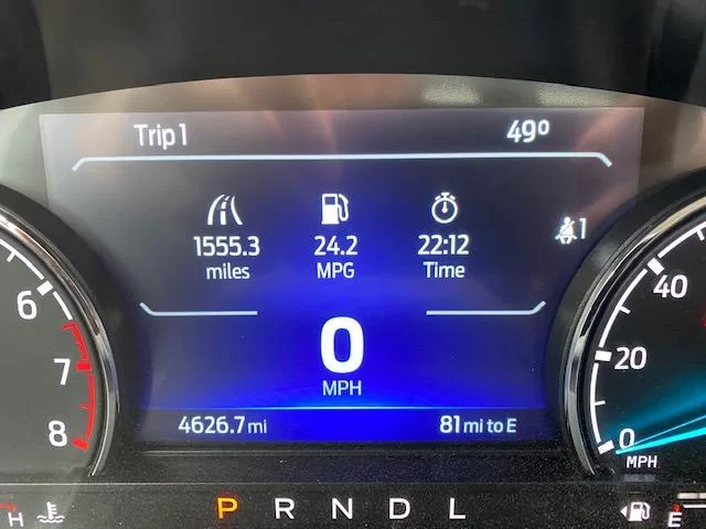

The fuel milage took a hit with the larger tires, which I knew would happen. The dyno alone it lost 30+ wheel horsepower from the added weight of the tires. I kept track on the way back, drove 1621 miles (Odometer is off 3 mph, haven't got the tire sized perfect yet in the ECU) in 22:12, giving me an average speed of 72.85 mph. There were times I cruised at 100 mph, most of the trip I drove 9 mph over the speed limit where I always do. MPG average was 24.2 mpg. Not bad for as hard as I drove but a long way from 30 mpg. There were a few times on the way out that I was off on old RT66 and drove 55 mph and did see 28'ish. This truck, to obtain 30 mpg, needs to be driven easy at 55-60 mph.
