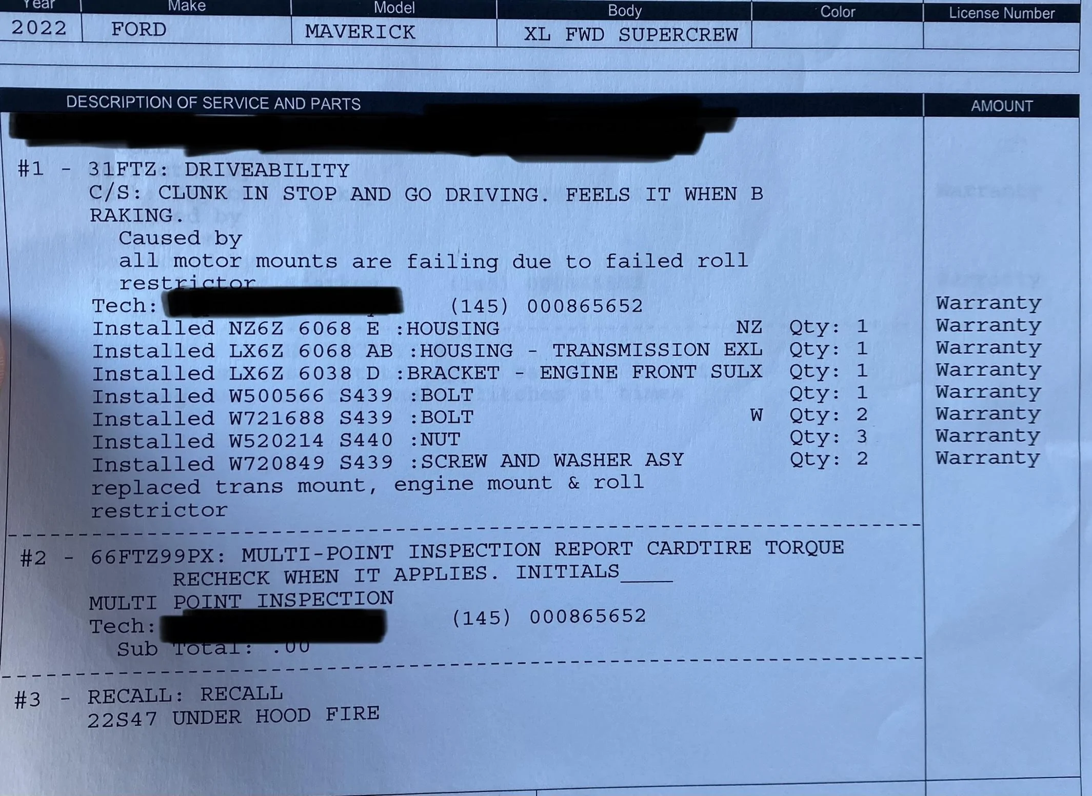

A while back I posted a thread about feeling a knocking in my brakes when I was in stop and go traffic. Sometimes it would be a light tap, but other times it was a very noticeable thud. Anyway, I just got it seen at the second dealership to try and figure out what was causing this and they definitely found something. The description in the attached invoice says “all motor mounts are failing due to failed roll restrictor.” I’m not a gear head, so I’m not sure exactly what this means, but it does not seem like normal wear to me. They claim to have fixed everything, but only time will tell if this actually fixed the knocking.
