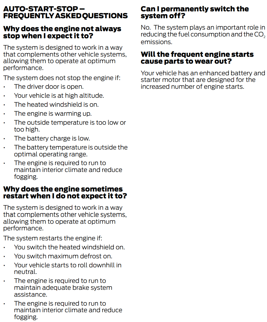

I may be one of the few who enjoys the auto stop/start feature but since our older F150 didn’t have it, the Maverick is my first vehicle that does.
That said, some days it works great and turns off the engine at almost every light. Other days it never will turn off the engine. Is that normal? Anyone familiar with how it should work? Thanks!
Edit: we have the EcoBoost so I’m not referring to hybrid electric to engine switching.
