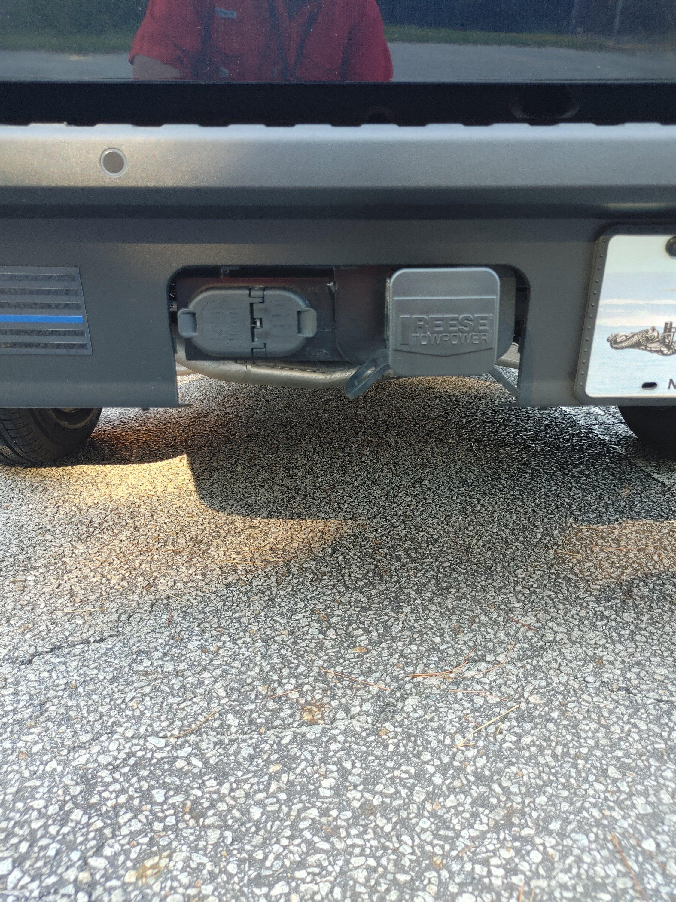

Anyone create/buy a cover for the hole in the bumper with hitch installed?
Montana
Jun 13, 2023
2,970
4,322
With 7 pin connector. Scratched it on the final fitting lol.
Did you just buy the normal one that is flat there and make the hole yourself? How did you fit it over the plastic cover?
If you have a heat gun, a very small.... I say again, very small lol, amount of heat will help to hide those small scratches. Too much heat though and you will end up with a glossy disaster.
just purchased the bumper cover (for those without a hitch) and some measuring and cutting does the trick. the scratches on mine are near the chain hooks on the hitch, installing was the hardest part of the mod for me. heating it up would require doing it while the piece is on the truck, but not sure I get how it will remove the scratches? heat it up and they scratches will disappear???

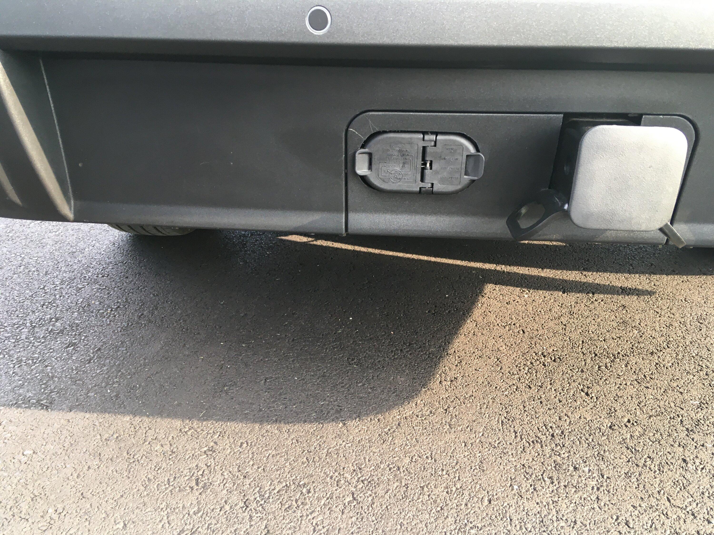

Yep regular flat trim piece. 7 pin connector will pop out. Take several measurements and cut to size. I tried heat gun but it didnt come out. A little tight sliding back together but it will go in.

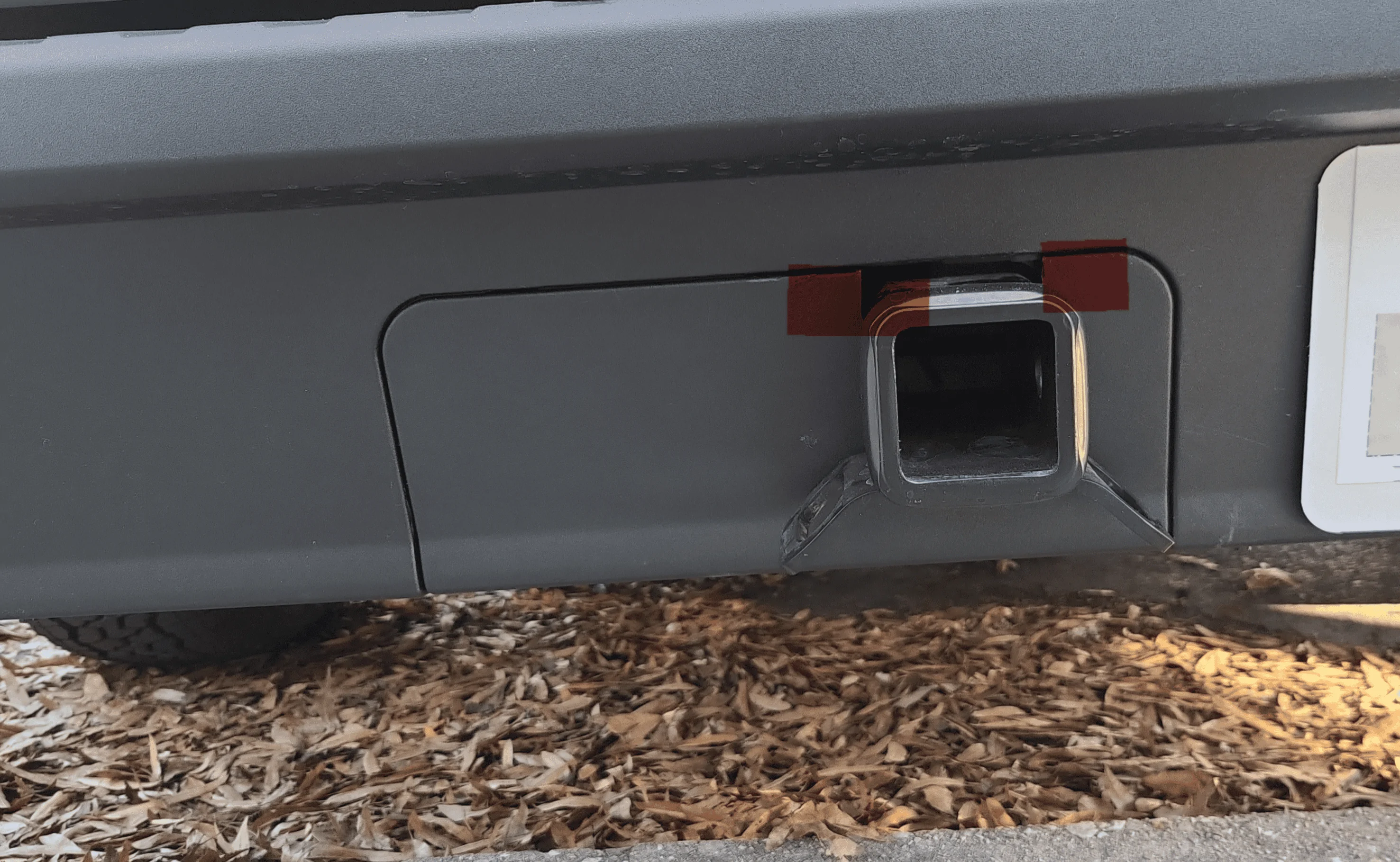

Least scratched I win... easy way to get it in if you don't need the 4pin.. where the red highlight is.. cut away the back lip part that tucks under. On the top left cut to right before the clip. Right side.. right before the curve. I ziptied the pins out of the way as I will never use it.
I used a Dremel
