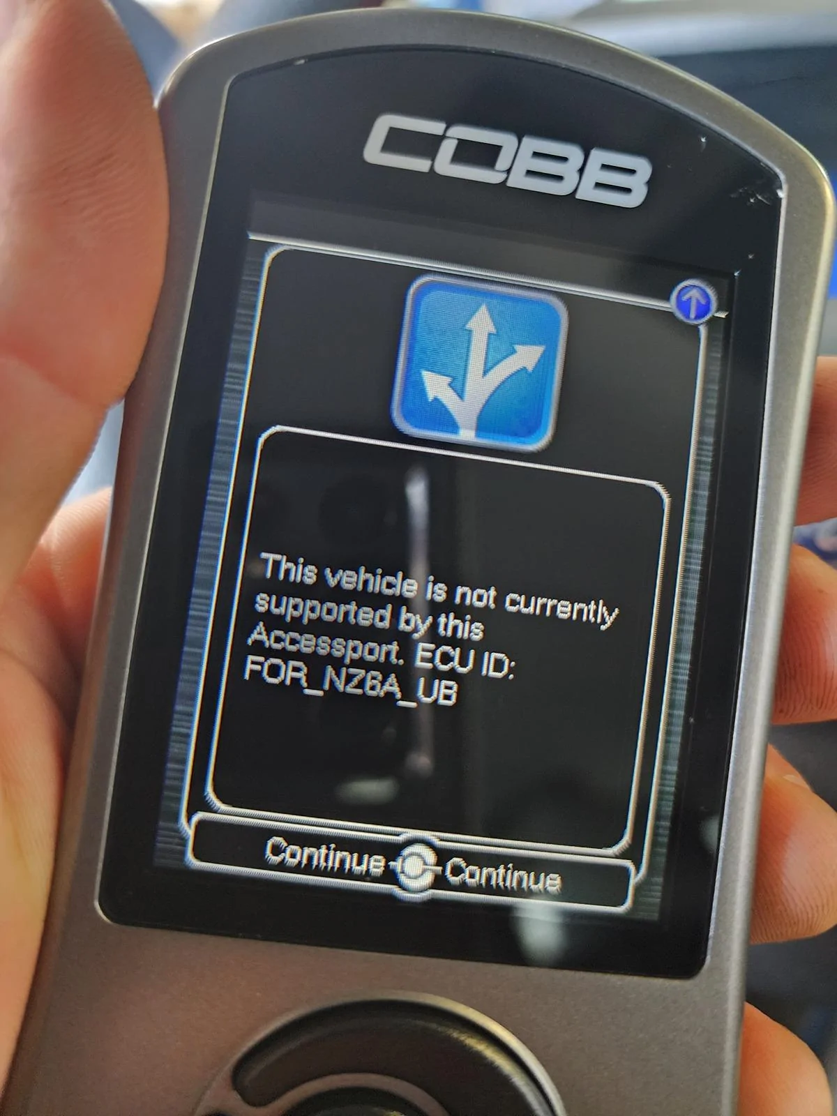

Hi I got a question I won one of your runners on the raffle but I can't get it to work with my vehicle any suggestions would be thank full thanks.
Heres the code I get when I do the install
Ford Maverick Any reviews with the OTS Tune? 20240606_171008

Hmm for some reason I thought that you already had a tune?
If you don't then the first thing I would question is if any of the mods you've installed that required Forscan changes might be causing it to read as an unsupported or currently unlicensed vehicle.
Have you gone through the troubleshooting chart here? I would contact Cobb Tuning for support after you work through the flowchart. https://cobbtuning.atlassian.net/wi...uick+Fix+Diagnosing+Vehicle+Connection+Issues

I had a 5Starz SCT tunner . I won the Cobb tuner and I need to use this one for some reasson for the 2.3 swap. I figure it out I needed to update the firmware thanks.

I would uninstall the SCT before installing the accessport. I assume it can be uninstalled, I don't know SCT.

Yes it's all set working great. I do feel the tune I had on the sct feels little better but probably I'm going to have to take my truck to get tuned with the Cobb now.
