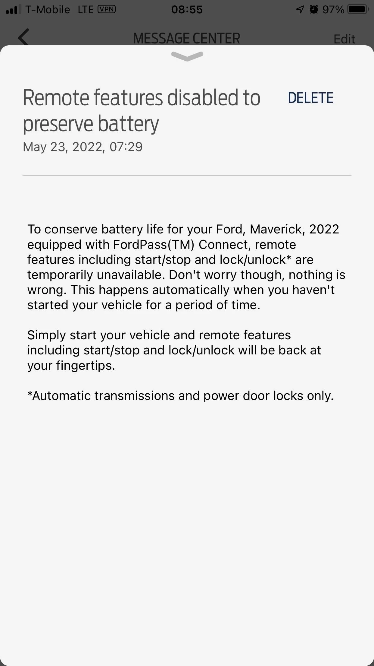

So I'm working in the backyard yesterday and I hear someone's car alarm going off, turns out it's my Maverick. I click it off and lock it up, no big deal. Well this morning I'm getting ready for work and it starts going off again. this time the below alert popped on the Ford App. Anyone experienced this as well?

I have gotten the alert twice but each time nothing out of the ordinary happened. I assumed buggy software was keeping something on causing a slow drain on the battery. It’s been a couple months since last occurrence so I haven’t the foggiest lol.

I did receive that message 1time, didn't really think much about it, turns out about a month later, 2days ago became a member of the Dead Maverick Hybrid Club now at the dealership was advised probably 2weeks waiting for a wiring harness.

Mine died as well, turned out the Ford Pass app was over communicating with the truck, they told me to remove the truck from the App,no issues since.
