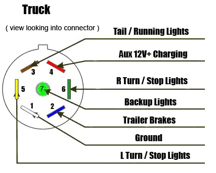

7 - pin vs 4 - pin flat connector. 7 pin gives you Aux charging, backup lights, and trailer brake control while the 4 pin gives you the basic wiring (running, L/R turn, ground). If you have the 7 pin connector on the Maverick and only have 4 wires on the trailer, there is an adapter for that.And the more important question, why do you need this? I very well might, but I know why I might.

I was asking the op why he needs the 7 pin. The uses for a 7 pin on a non 4k truck are minimal at best. I have one of those uses. Does the op? I wire all my trailers with brakes......even the small ones7 - pin vs 4 - pin flat connector. 7 pin gives you Aux charging, backup lights, and trailer brake control while the 4 pin gives you the basic wiring (running, L/R turn, ground). If you have the 7 pin connector on the Maverick and only have 4 wires on the trailer, there is an adapter for that.

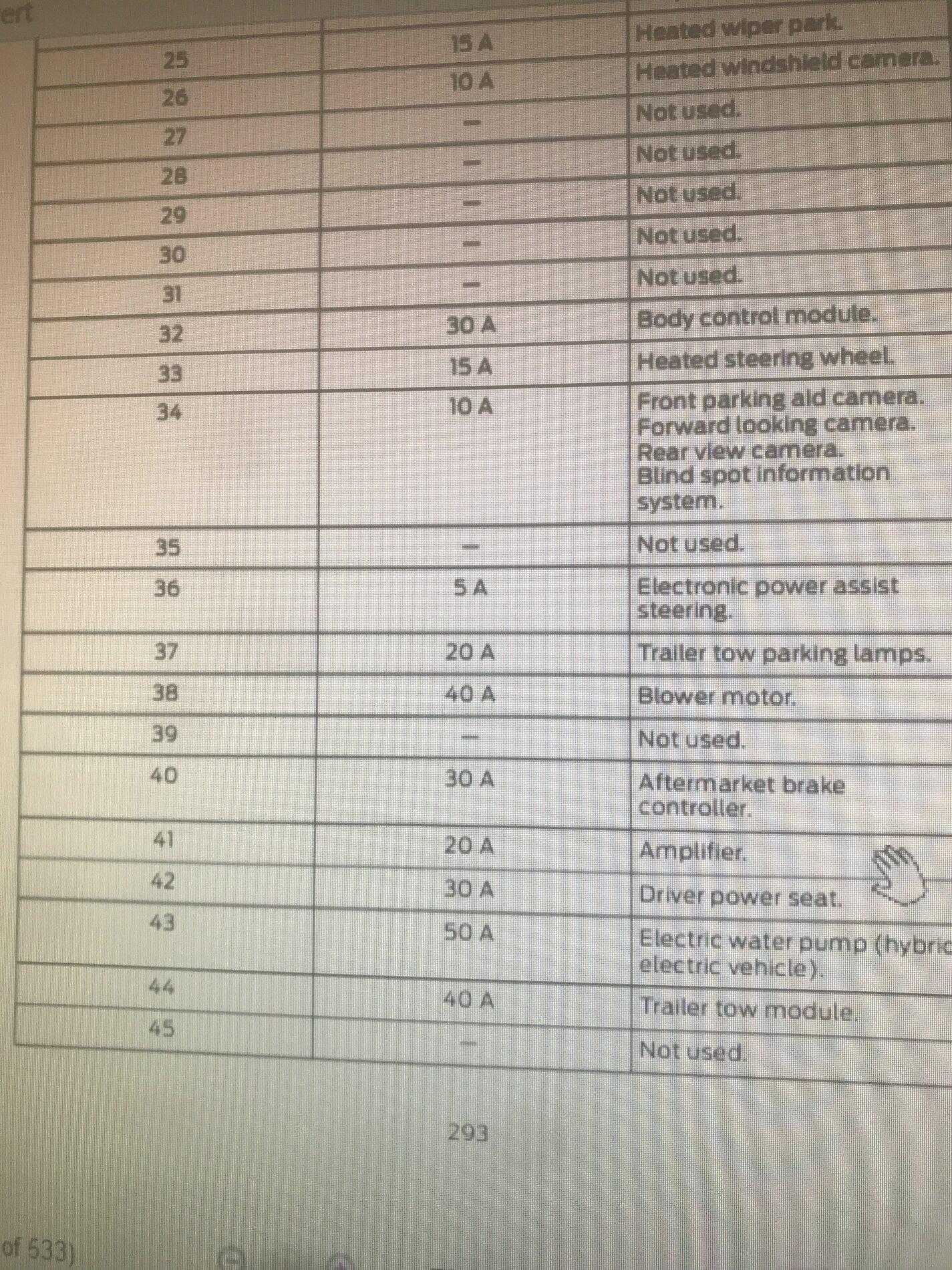

That's what I like about the Maverick. So many people have so many different needs for this truck and it fits the bill for most. In this case we know the fuse box supports aftermarket brake controller so this would be a perfect solution.Need the 2.0 and the 4k package for those. I need the hybrid with the receiver hitch for occasional towing. The 4k is not reasonable. It adds substantial costs.
