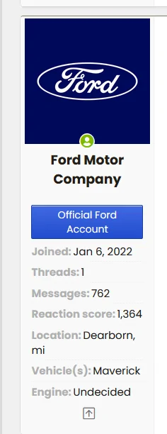

Hopefully Ford will contact you for info or maybe you can PM them with your issue. You may have to look this up under members to get the contact.
