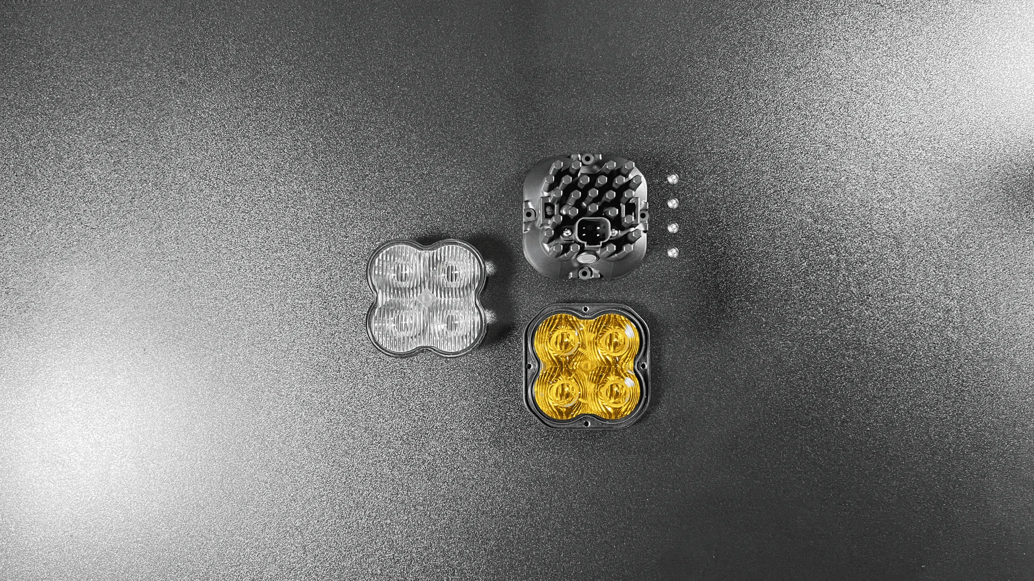

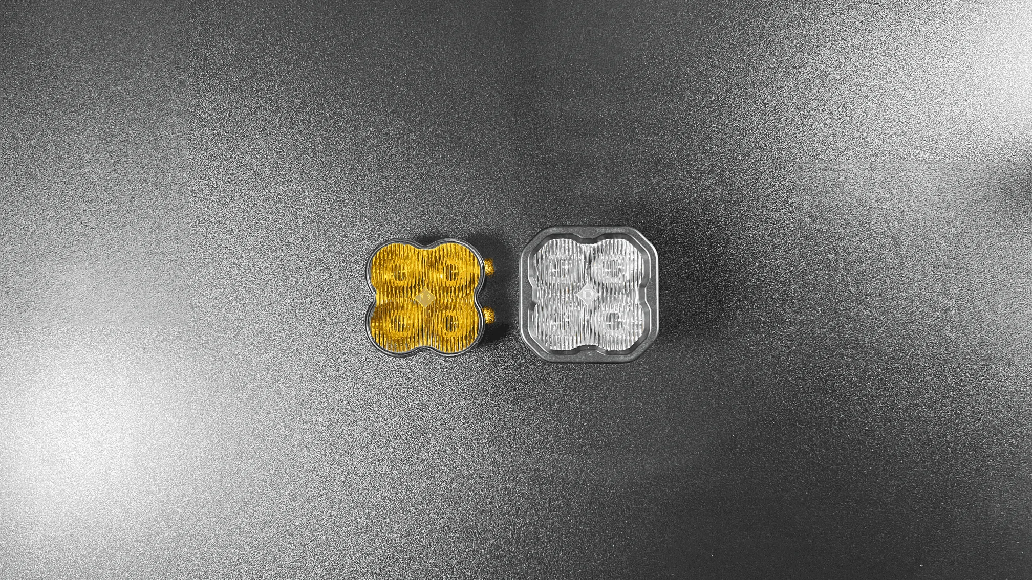

Begin by purchasing Sport/Pro Stage Series LED Pod in yellow with a separate white TIR optic.

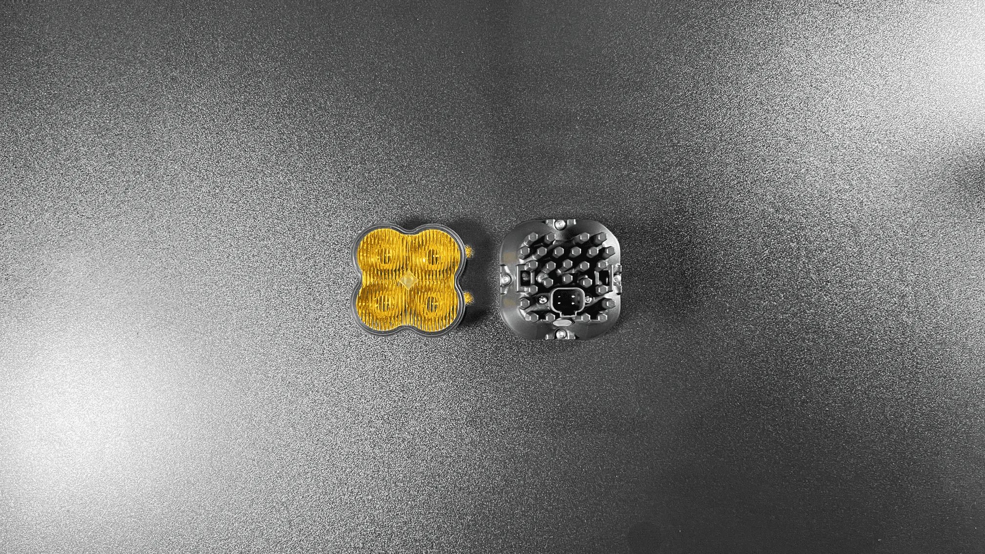

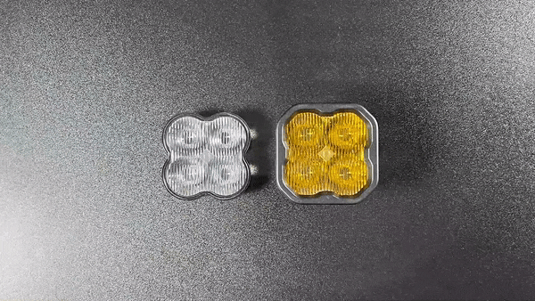

Flip your Stage Series LED Pod over and remove the hardware securing the bezel, TIR optic, and housing together.
With your hardware removed, separate the housing from the TIR optic and front bezel.

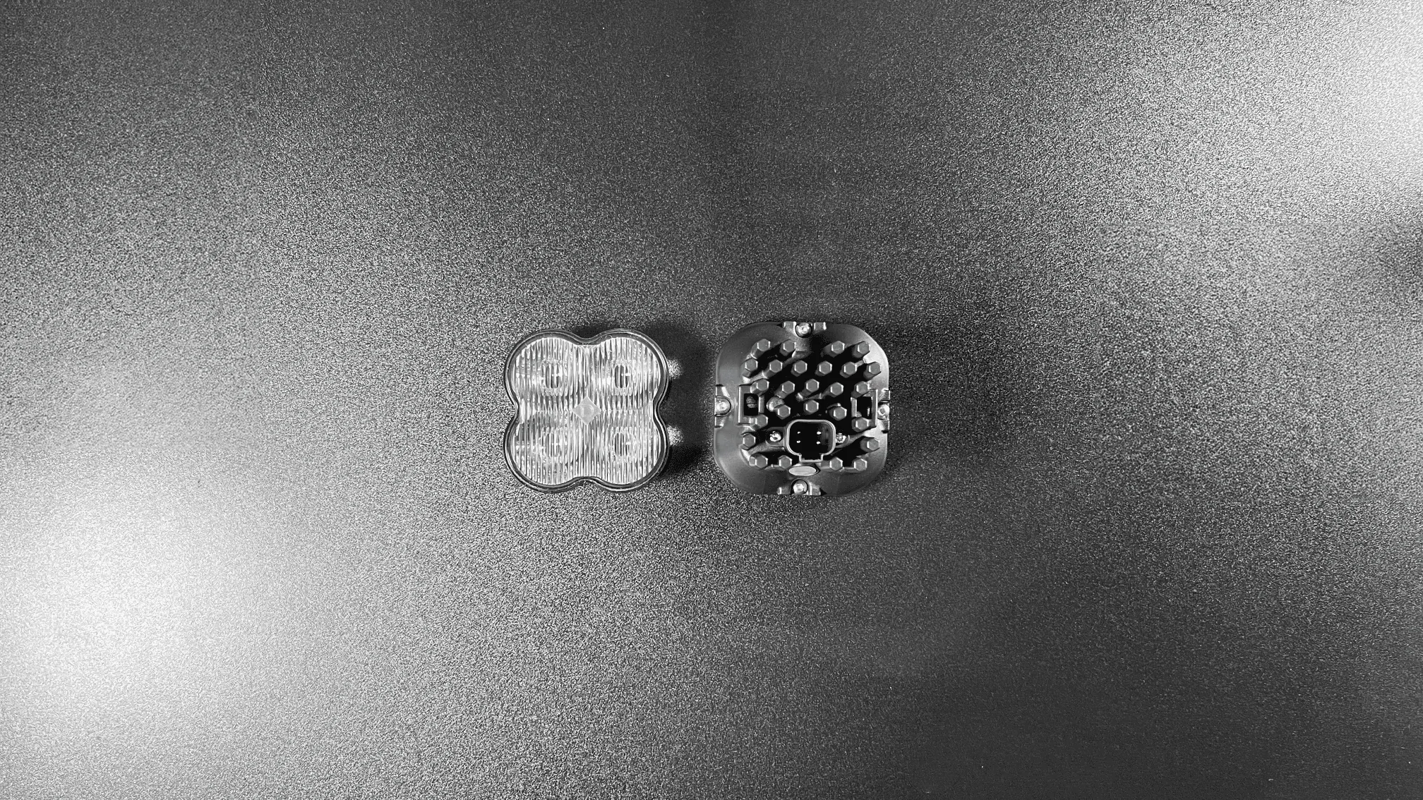

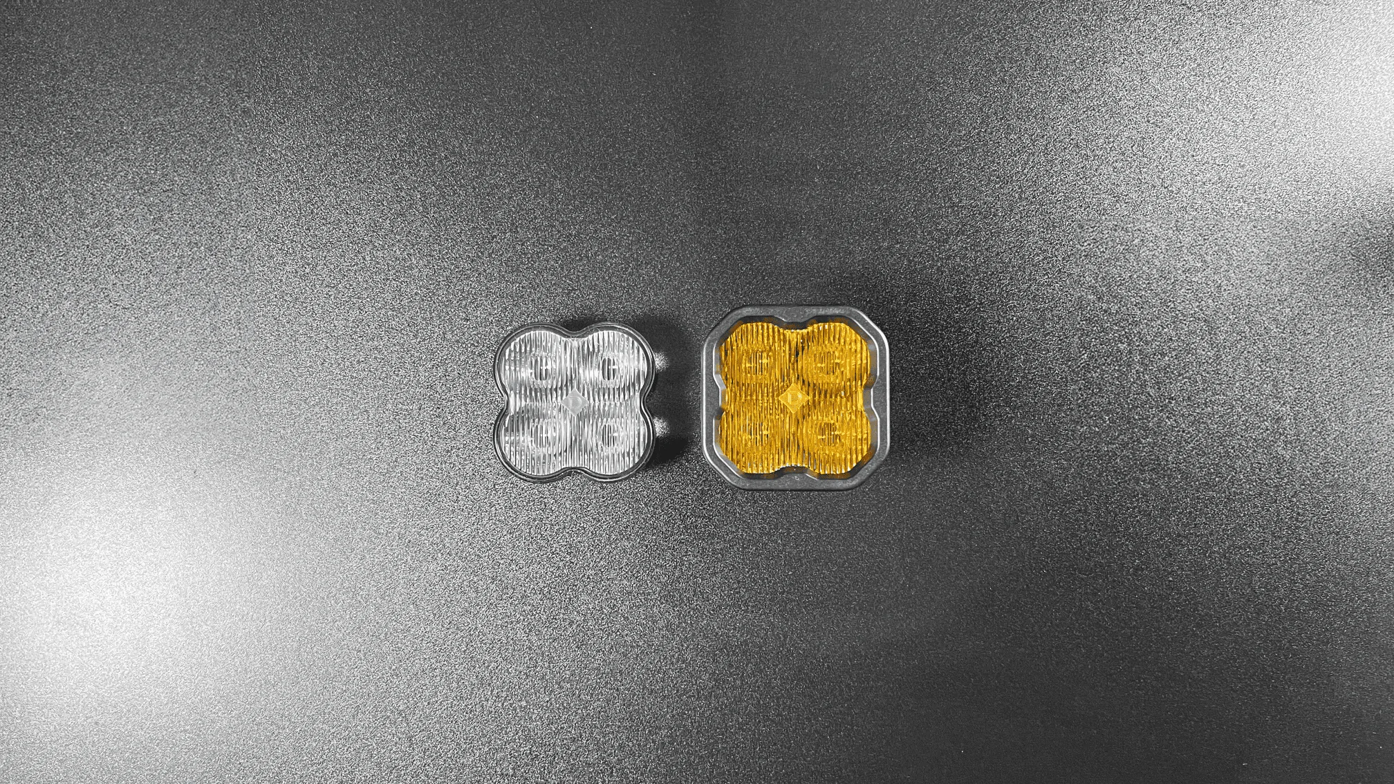

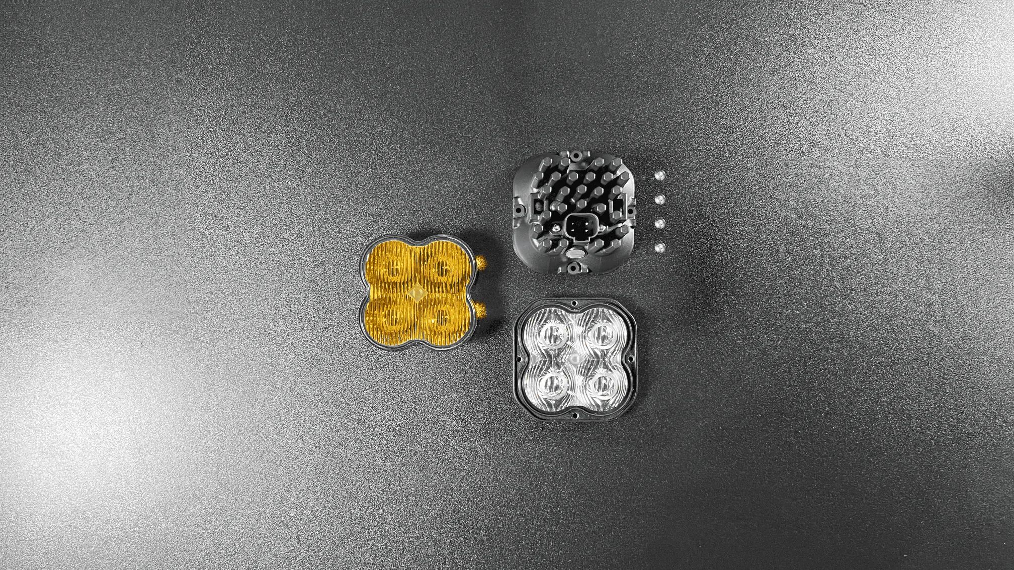

You can now swap the original yellow TIR optic and place a clear/white TIR optic in place.
The housing can now be placed back over the TIR optic and front bezel and resecured using the hardware removed.

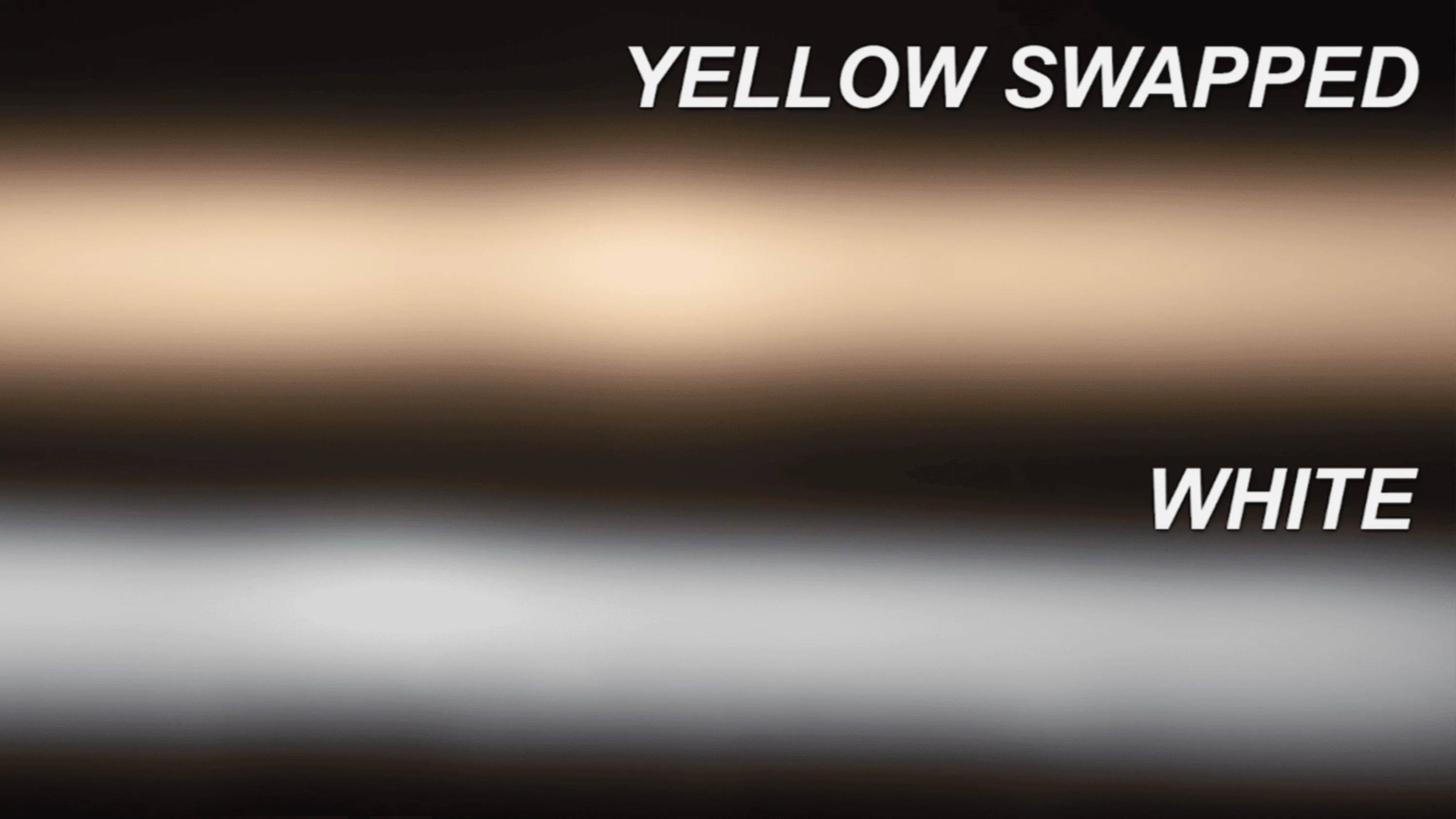

Now you've successfully swapped your Stage Series LED pod in yellow to a clear optic. This will allow for the original warm white LED chips behind the yellow lens to produce a 4300K warm white output through the clear TIR optic.

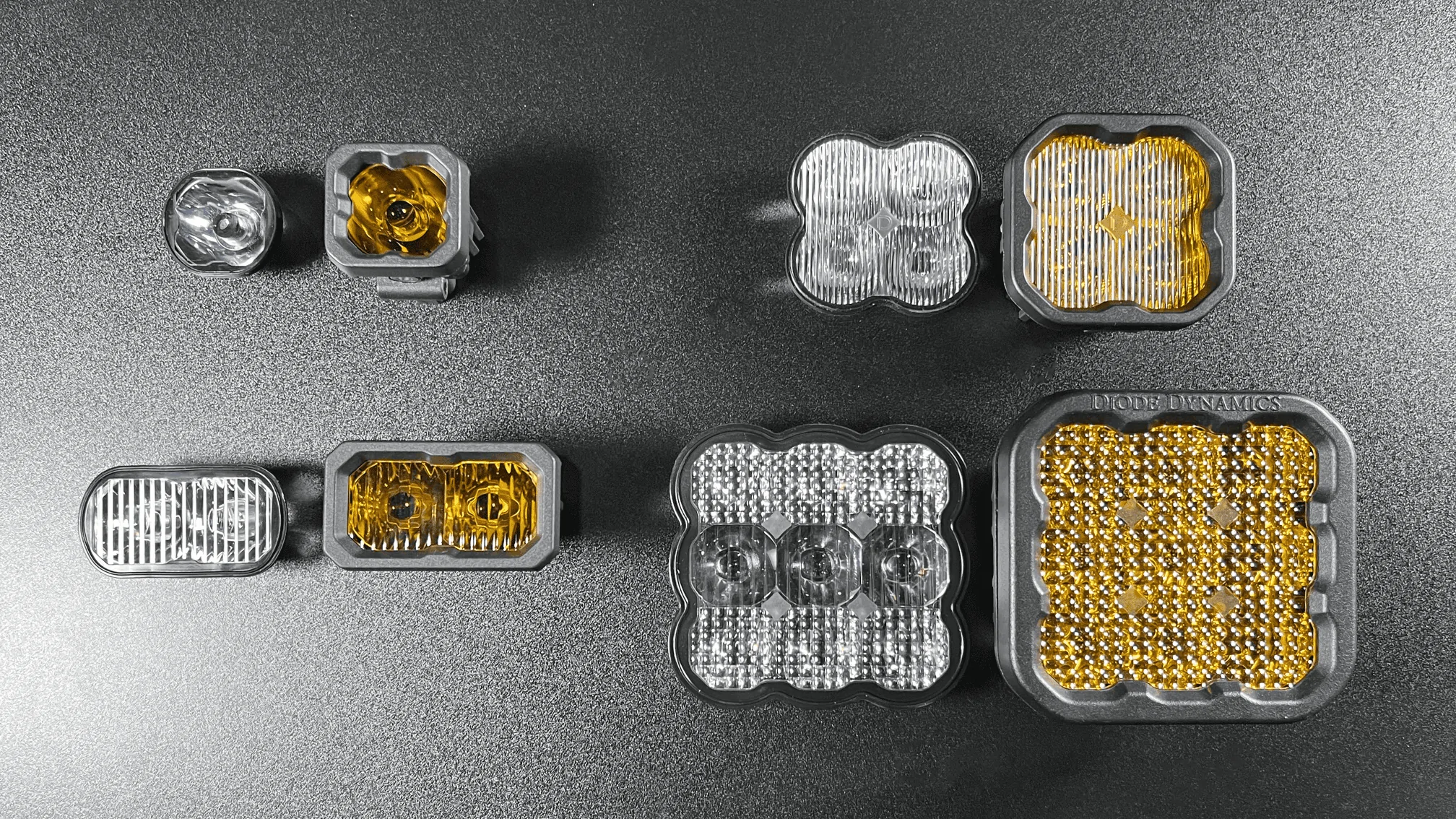

Additionally, our warm white output can be achieved with the following Sport/Pro LED Pods: SSC1, SSC2, SS3, and SS5!
To obtain a warmer white output, you'll need to purchase the following pods of your choice:
• SSC1 Yellow (Sport/Pro)
• SSC2 Yellow (Sport/Pro)
• SS3 Yellow (Sport/Pro)
• SS5 Yellow (Sport/Pro)
