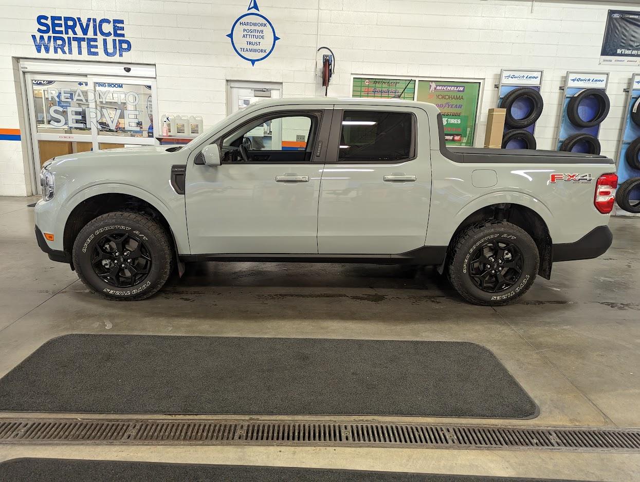

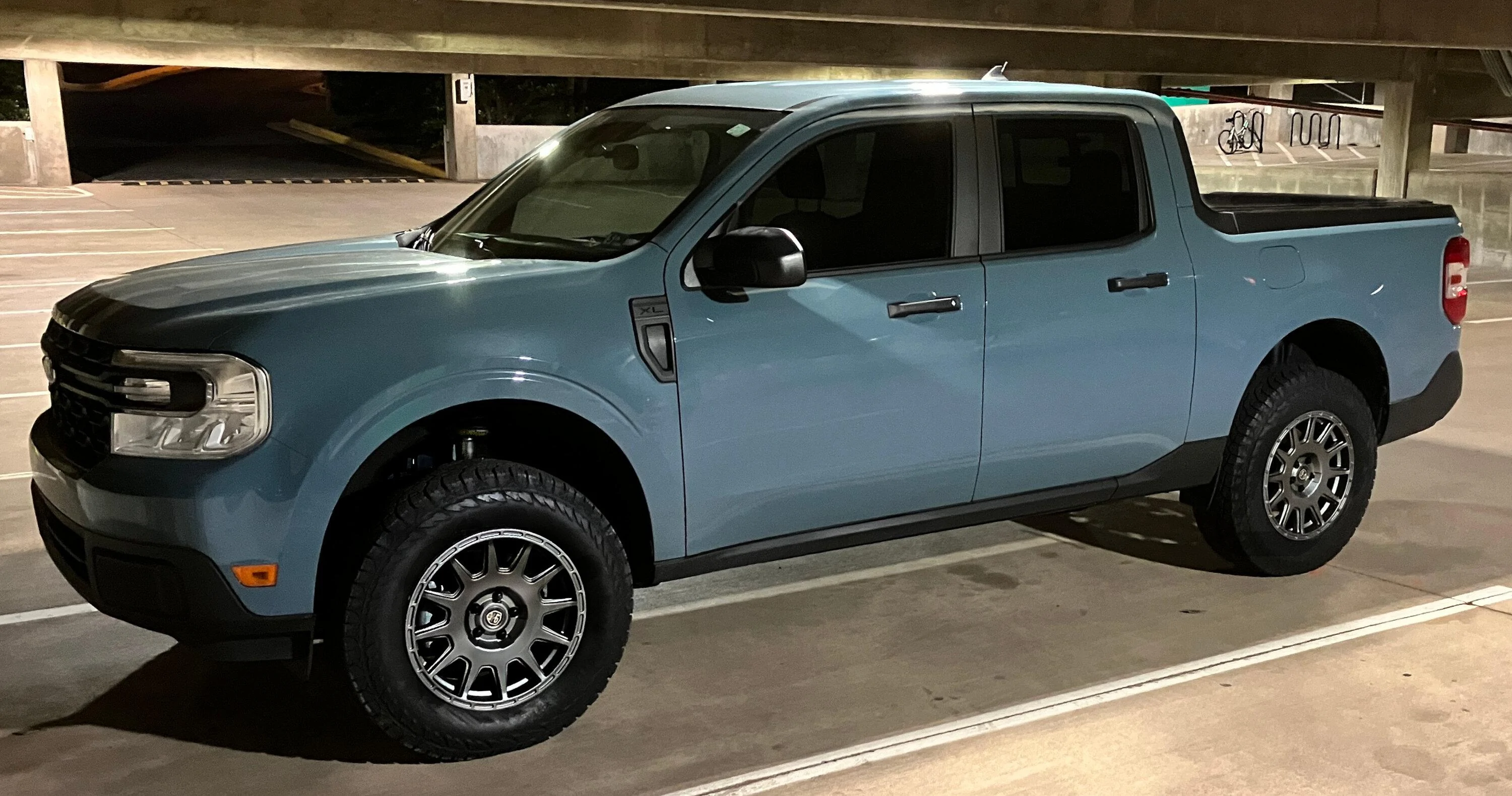

2022 XLT 2.0l AWD with 2 inch lift 255/75r/17s stock wheels.
Which lift did you go with? There are several options available now. I have the Rough County 2" strut lift... sitll in the box . I need to decide what tires I'm going with before I install. Please as requested above, DETAILSBy Mavnick Overlanding

I am 99% sure I am going to go with 265/65/17s. Their is another member here running those with no lift. But hopefully we will get some details from the OP on the exacts on his setup.I third what others have said. Details on your tires/rubbing would be appreciated. I have the 2-inch Eibach lift springs on the way and was thinking of going with 245/70/17s but maybe I can fit even larger?????
Almost guaranteed to rub with those unless you're looking to do some pinch weld modification and wheel well liner cutting......I would bet that OP had to mod the pinch weld and liner as wellI am 99% sure I am going to go with 265/65/17s. Their is another member here running those with no lift. But hopefully we will get some details from the OP on the exacts on his setup.
I don't know why but I just find it hard to believe, it's a 30.6" tire AND it's about an inch wider than the 245/70R17 that people can't really seem to get to work without rubbing with the exception of the Toyo ATIII in that size. 245/70R17 is a 30.5" tire and the Toyo ATIII is in reality a little shorter than 30.5" which is why it fits without rubbing. By all means, go for it but I'm going to bet that it does rubhttps://www.mavericktruckclub.com/forum/threads/who-needs-a-roof-rack.12020/
Thread linked above 265/65/17s (post 18) completely stock suspension. Driving through sand and ruts in PR. No rubbing and no pinch weld or liner modifications. I just figure if he can do it on stock suspension I should be able to do it with a 2" lift, but of I have to bang a pitch weld... that is fine. My warranty is basically done anyway. Maybe 3 more months
