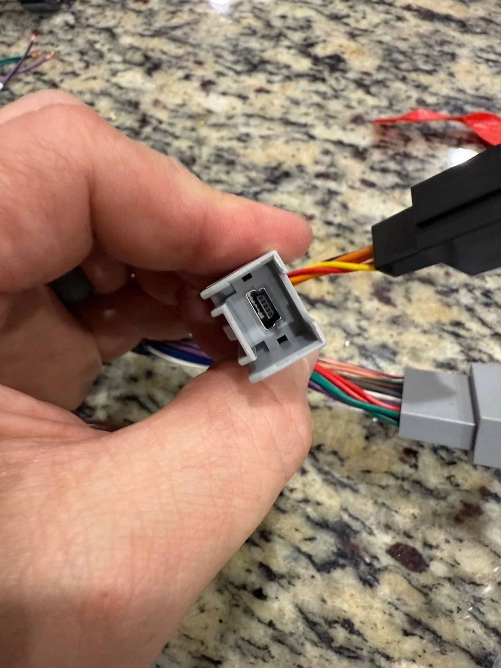

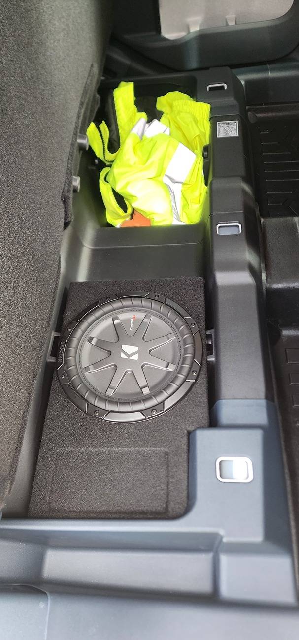

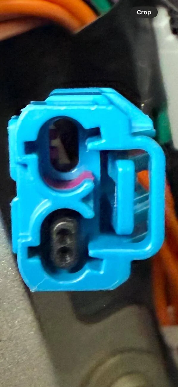

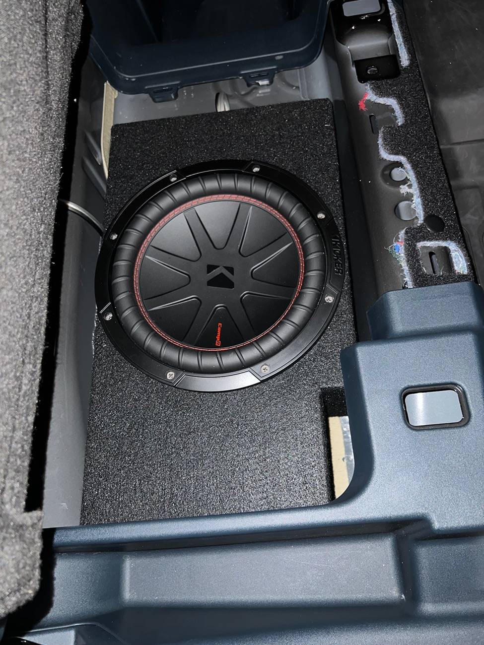

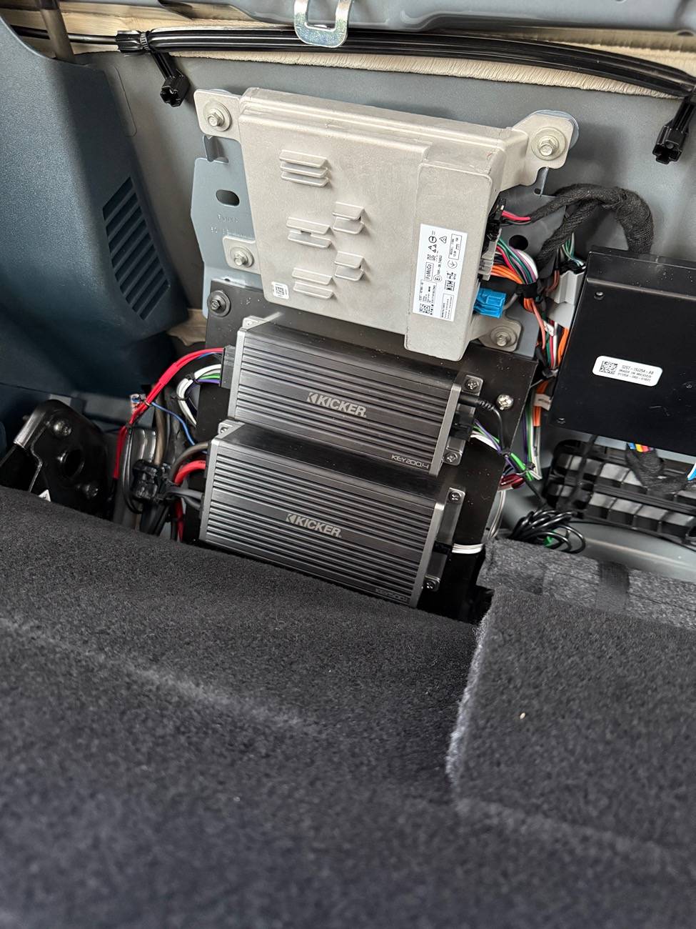

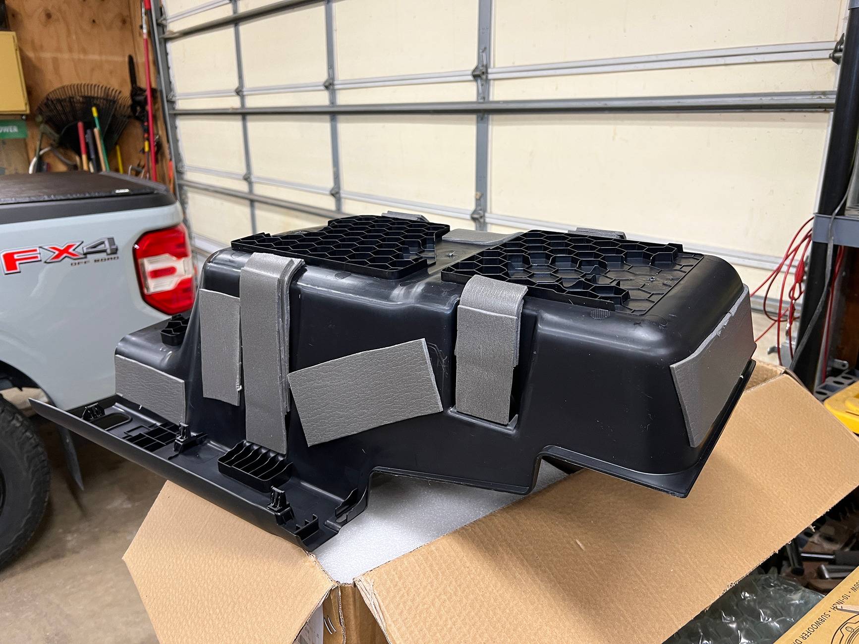

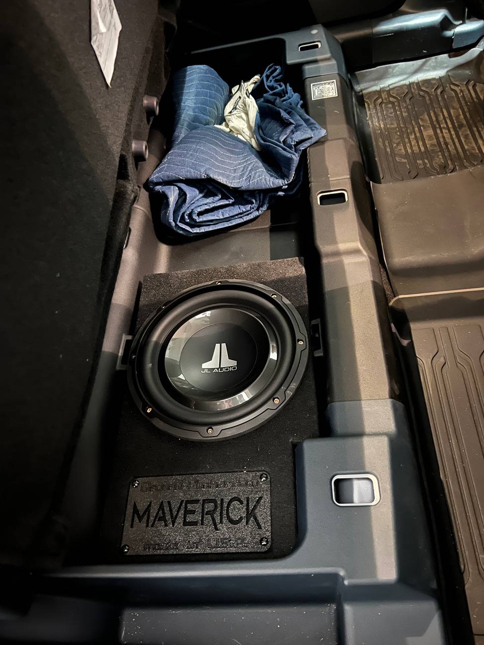

I did the shallow 10” L7. The ground shaker box is .65 cf and acoustic-stuf makes a huge difference in the depth of the bass. The Kicker key amps are perfect to clean the sound up without buying a separate DSP. In the MY ‘25 B&O amp the signal in has changed from micro-usb to what looks like optical. There aren’t any adapters on the market for it yet that I’ve found. I’ve personally confirmed PAC, NavTV and iData do not work. The PAC APH-FD02 harness is the easiest thing I’ve found to avoid actually cutting into wires.
The PAC AmpPro doesn't work in the MY25?
