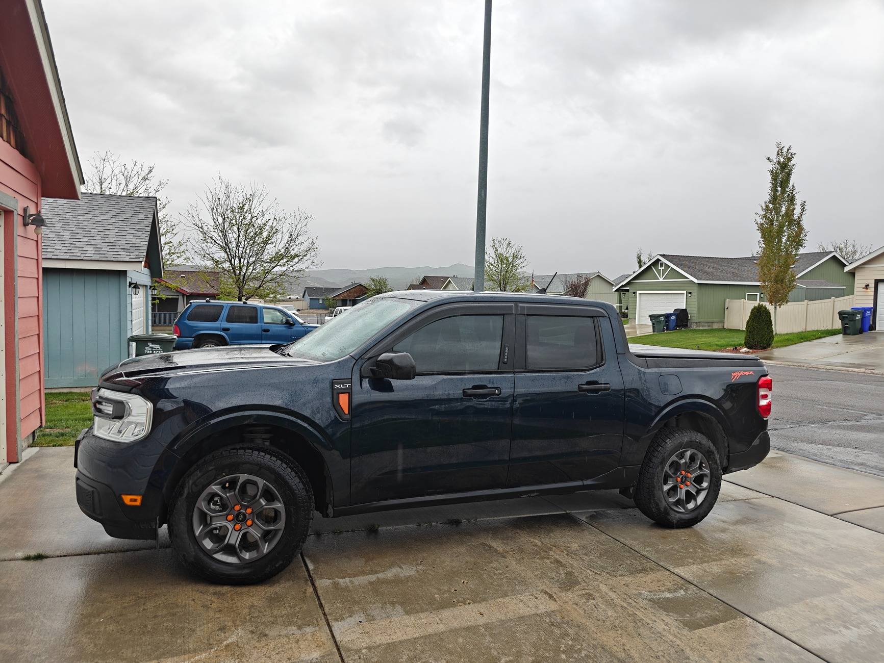

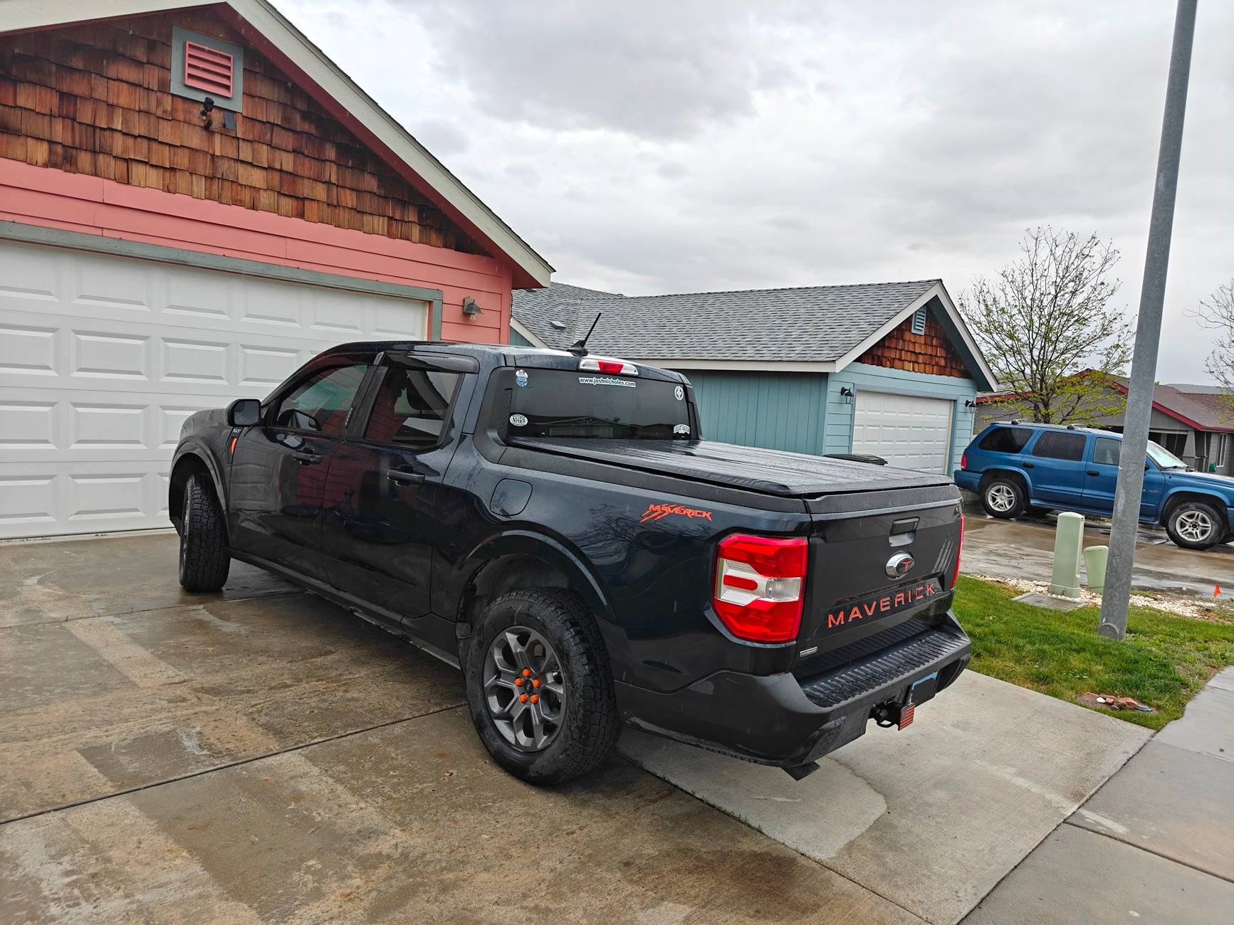

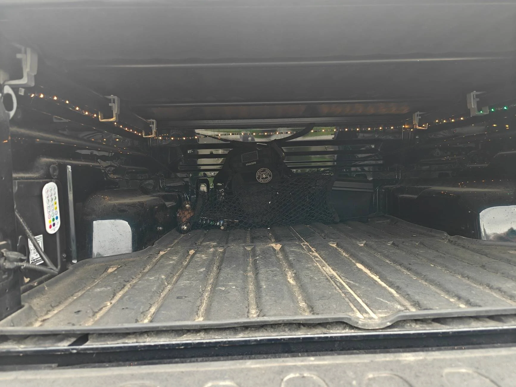

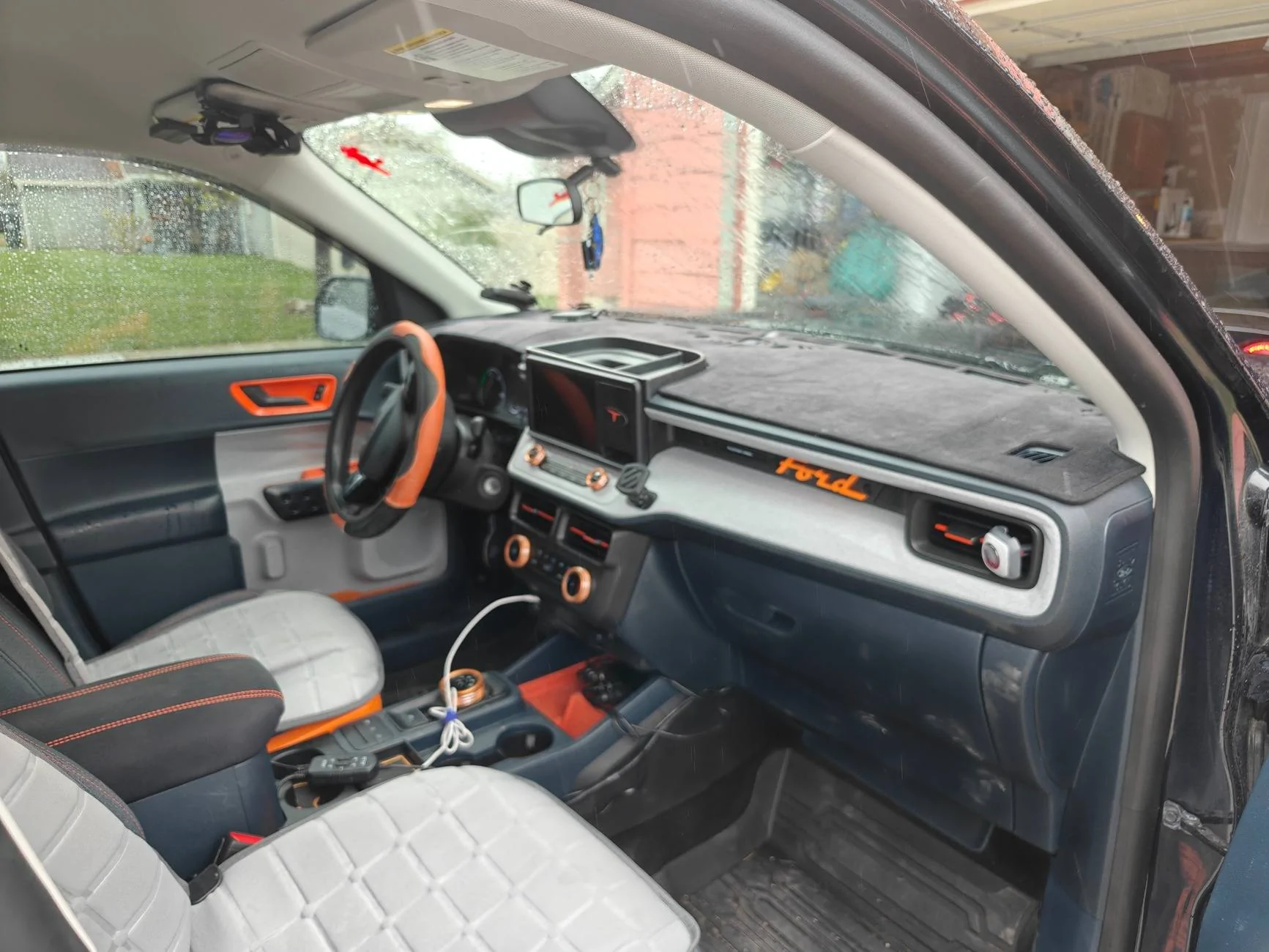

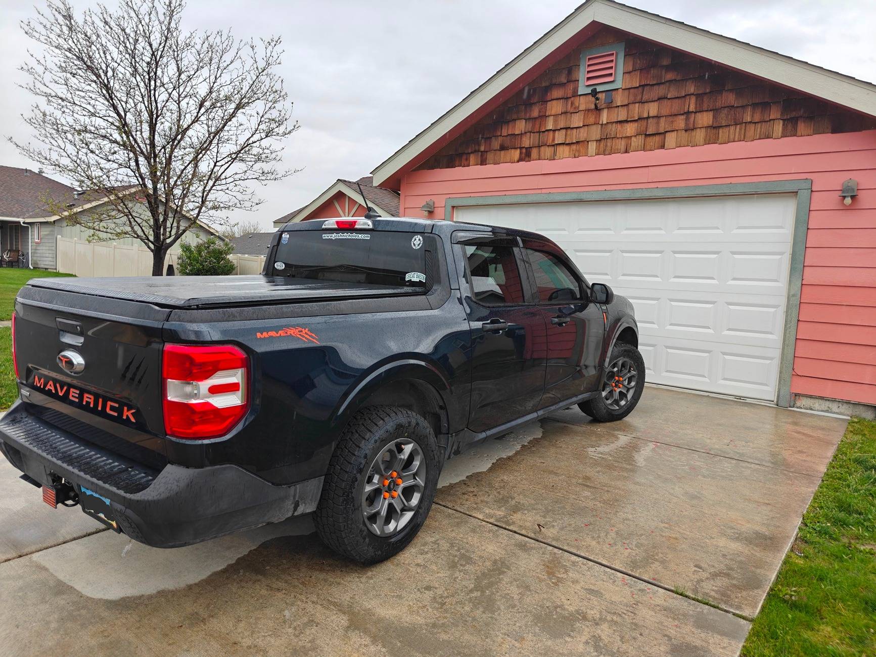

I have completed all of my customization. I decided to share here.

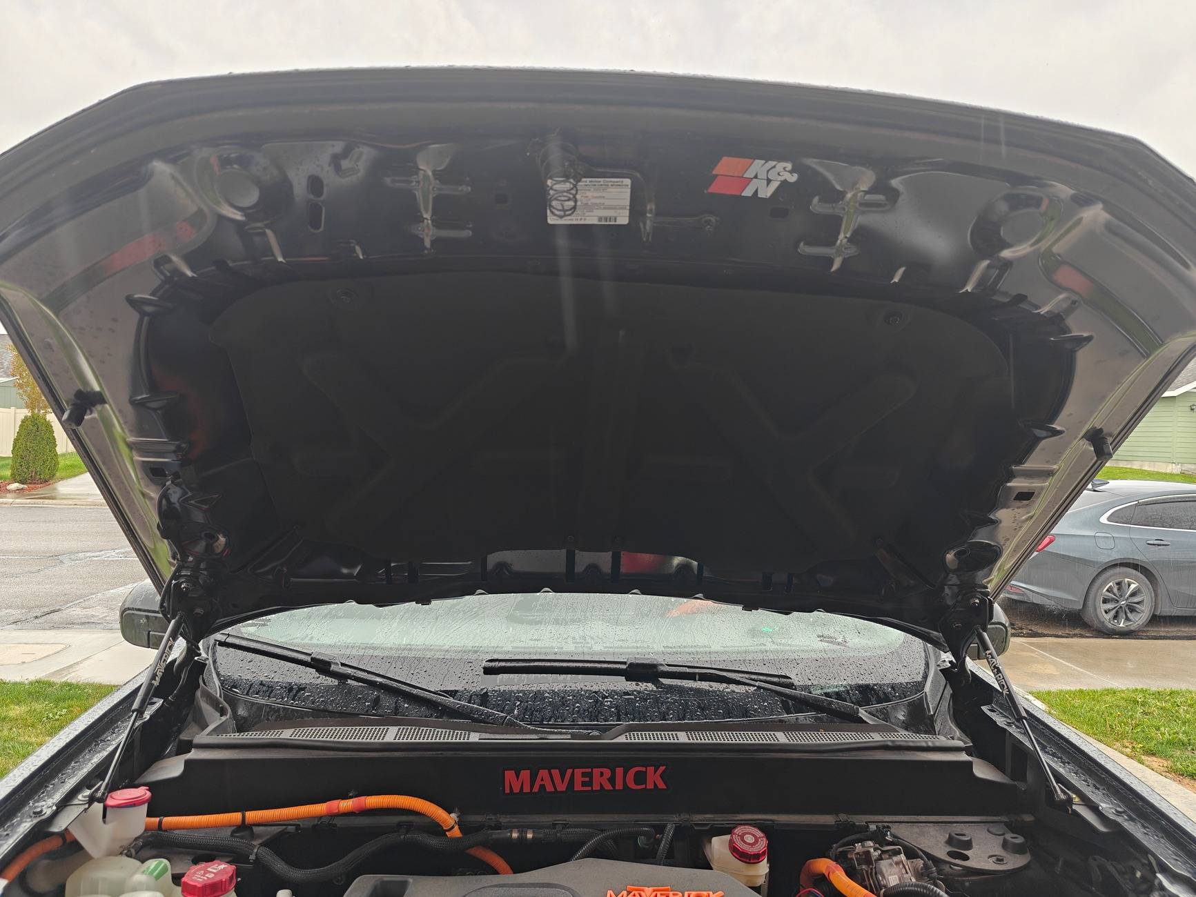

Hi, the red accents look pretty sharp. I curious to know what it took to mount the engine cover on the hybrid? And where did you source it?
Thanks.
As you probably know, the one that is an exact fit (that I am still trying to get my hands on) is discontinued and impossible to find. This one is a retrofit, I had to trim the foam, invert it, and 3d print a cap piece and cut a new opening for the dip stick and oil filler cap. That said it is a cover from a 19-23 Lincoln Nautalis 2.0, and I ordered the engine stud and nut for the 19 - 23 Ford Escape to attach it. You can get them on eBay.
It is not a perfect fit, but it looks better than it did without it.
Thank you for that information. much appreciated.
