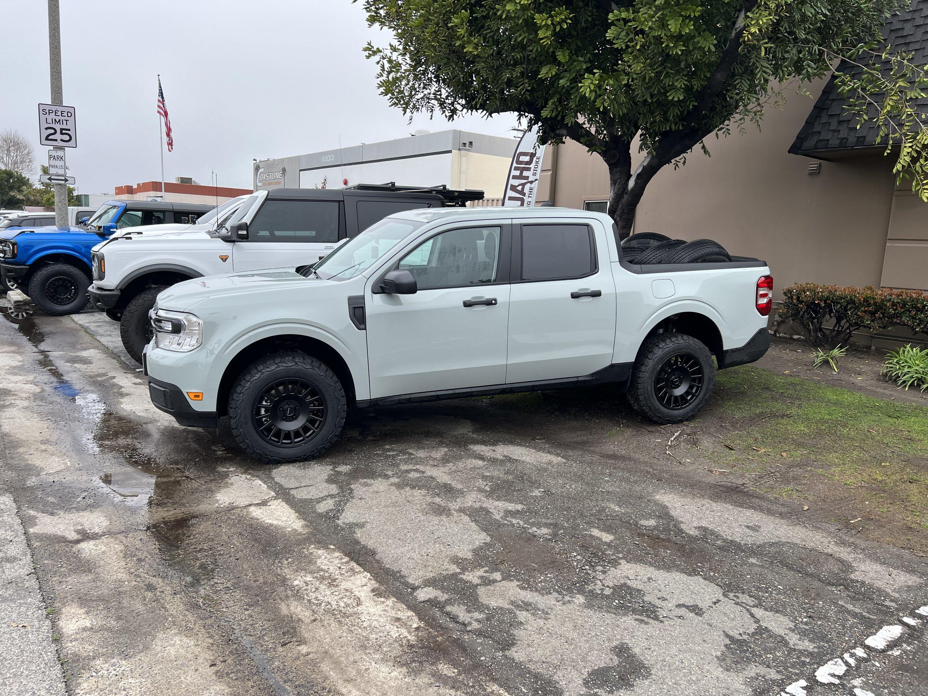

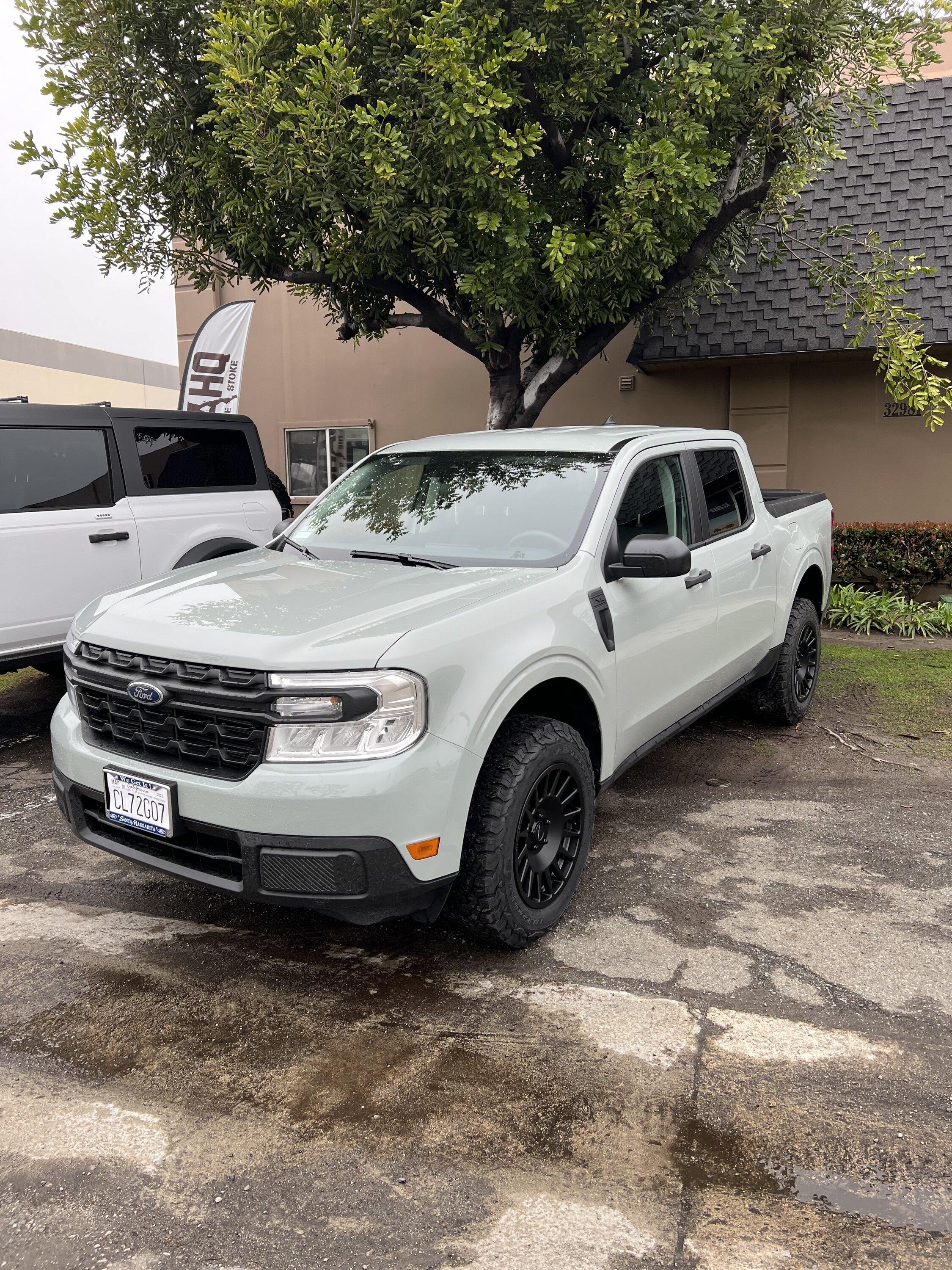

Got my Mav all finished and she’s looking beautiful, tires just a tad bit small, but didn’t want to cut or have any rubs.
UPDATE—- I would not really recommend the HRG OFF-ROAD LIFT, the quality is not the most solid and has landed my truck back into the shop, it’s very hard to explain what happened to the lift, but a pothole hit and it threw my whole coil off of my rear left suspension. It is just not a solid made lift, aswell as it leaves the back suspension feeling very very stiff. Id highly recommend going with the 1” leveling kit from Rough Country!
-HRG OFF ROAD 1.5in lift
-Method MR707 wheels 17”
-BFGoodrich k02 245/65R17

That does look nice. How much is it to put a lift on that?

Paid I think around 1100 with installation, lift kit was 450$ install was like 700$

How much does the lift affect your MPG?
Edit: just saw your edit in the OP about the kit throwing off one of your suspension coils. Ouch. I guess are you going to revert the lift kit or try to fix it?

It only seems to effect it like .5 mpg, havent seen a hard drop as of yet, i tend to drive on eco mode and im getting about 32, and was previously getting around 32.5-33.
What i ended up doing was removing the spacers in the rear end, spacers were about 3/4 INCHES tall, so it made my rear end very stiff which was partialy the issue to the coil fall out. So i still have the 1.5 INCH lift in the front and the back end is back to stock.
