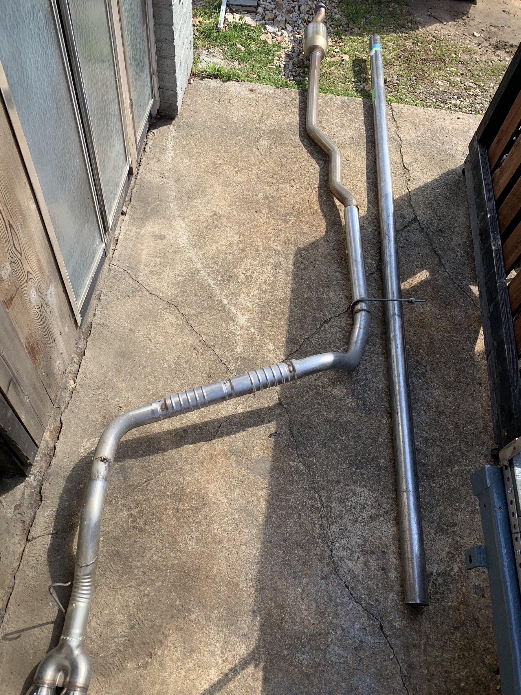

Keep that monitored turbo cat, separate the v clamp to remove the whole exhaust piece. Just cut 1/4” post inlet weld on the secondary cat, weld this on…
not even loud at all.
Initially, I had just bypassed the mufflers first, but that was silly quiet.
Shown below on left is stock pipe w/mufflers bypassed test setup

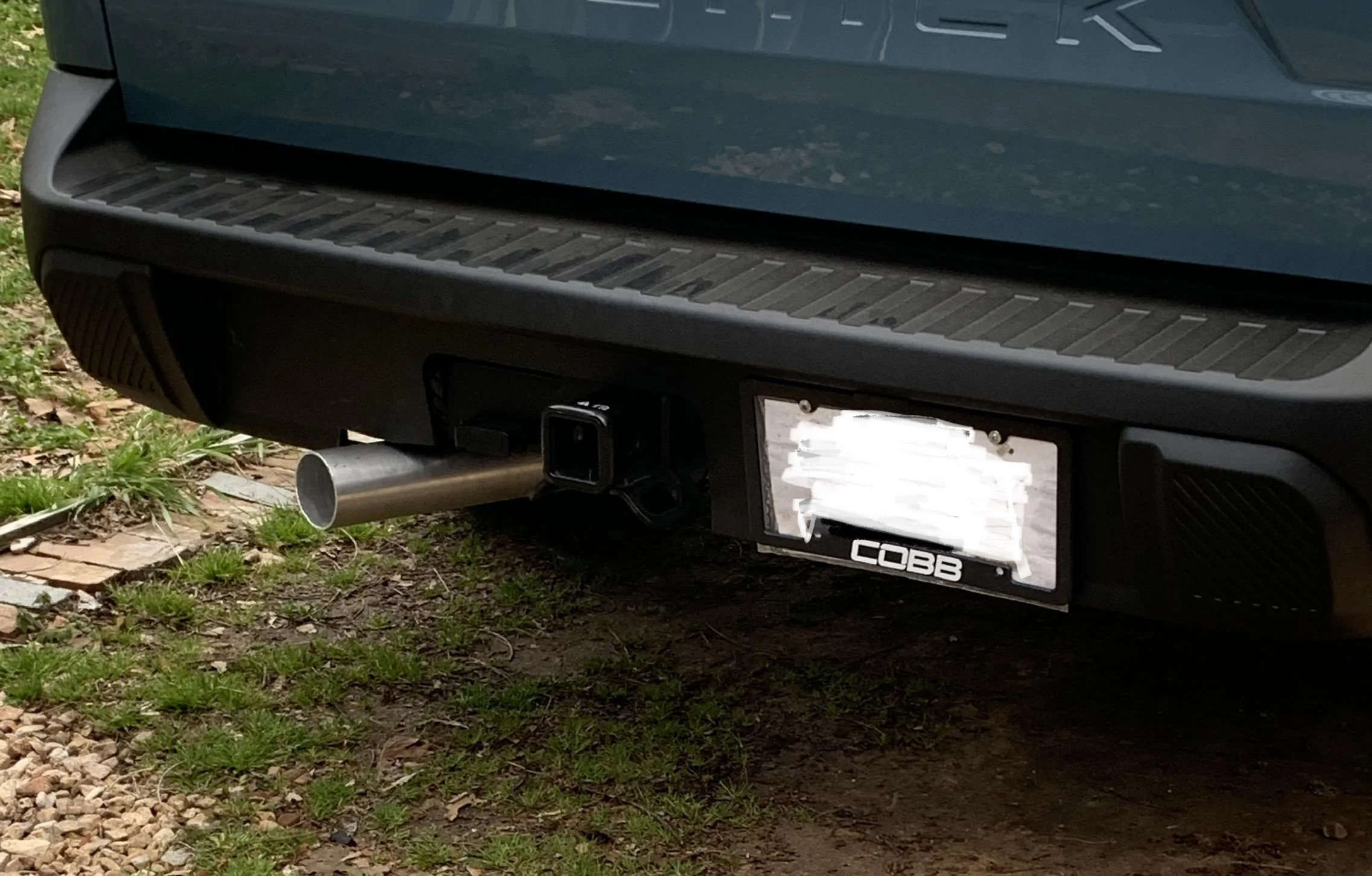

I put a 37 degree pie elbow just aft of the swing axle & added a spun aluminum tip
