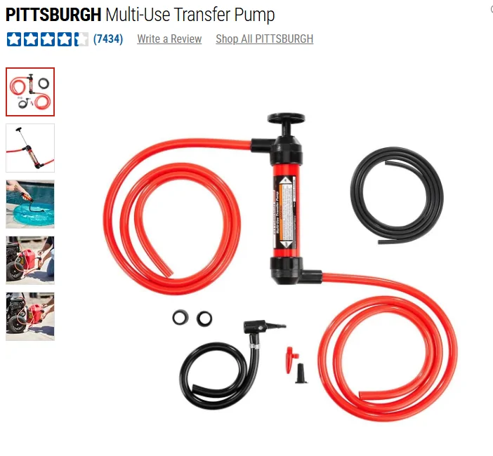

My 2022 2.0 EcoBoost Maverick required a cooling system flush (and cooling expansion tank replacement due to a crack).
In the process of this, I needed to buy a hand transfer pump (less than $10 at Harbor Freight) to pump the dirty coolant out
of the leaky coolant expansion tank so it could be replaced prior to the cooling system flush and refill.
Here is the Tip: After replacing this tank, I was about to drain the cooling system using the 'petcock' valve on the bottom of the
driver's side of the radiator, when I realized that even draining this old coolant in to a bucket will be a mess and connecting
a hose to the petcock and putting the other end into a container would be far easier and cleaner. I looked around in my garage
for a small piece of hose that would fit the outlet on the petcock and at least 2' long to hang down into a drain container (truck was
up on ramps). The red hose that comes with this inexpensive transfer pump is the perfect diameter and plenty long enough. This is
worth the $10 alone - plus these pumps are great around the shop for sucking gas out of lawn mower gas tanks so you can tip over
for blade shapening....etc.
