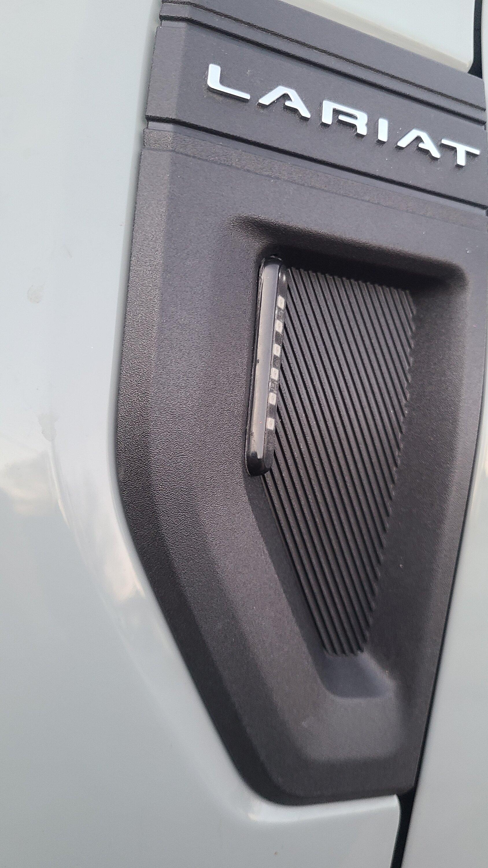

It seemed like too tight of a fit to mount horizontally like others have without boring out a largish hole, so I stuck my LED strip on vertically instead. It's about as perfect of a fit as you can hope for. Slightly more conspicuous than horizontal, but looks much better in-use imo. There is no light spill into the cabin.
The lights themselves are great. Good, not blinding, intensity. Crisp and easily noticeable. Wiring the lights in was dead simple.
The Maverick's stock blinker layout is invisible to any cars that are abreast of you - really unsafe. These give me much more confidence when changing lanes in heavier traffic.
Ford really skimped on a lot of small things to cut costs on this truck. I'm glad it has been so simple to add them myself.

I had the same experience with the LED strip lights . . . just seemed a bit too squeezed in for a top mount, but unlike you, I abandoned using that light and went with cutting a hole in the badge to mount a round LED and cover it all up with a made to fit amber cover. (See my initial thread). I think how you re-thought using the light strip is brilliant.
Seeing your original post is honestly what inspired me to jump in and really start looking into these functional mods. Not sure how I came across it originally, but as soon as I saw your thread, I knew I needed to install those lights.
Makes me smile every time I see them flash! Sure doesn't take much to please me as I get older lol.
I made a small slot on each side of the cover and the LED strip fits well at the top. I just like the less noticeable strip when mounted in the horizontal position. If I do it again, with new covers, I'll do your method. Thanks for the inspiration.
Agreed. I liked it better at the top horizontally. You're welcome. That's what this forum is about: Educate, Inspire, Inform. If/when you decide to re-do, I'm happy to help in any way I can.

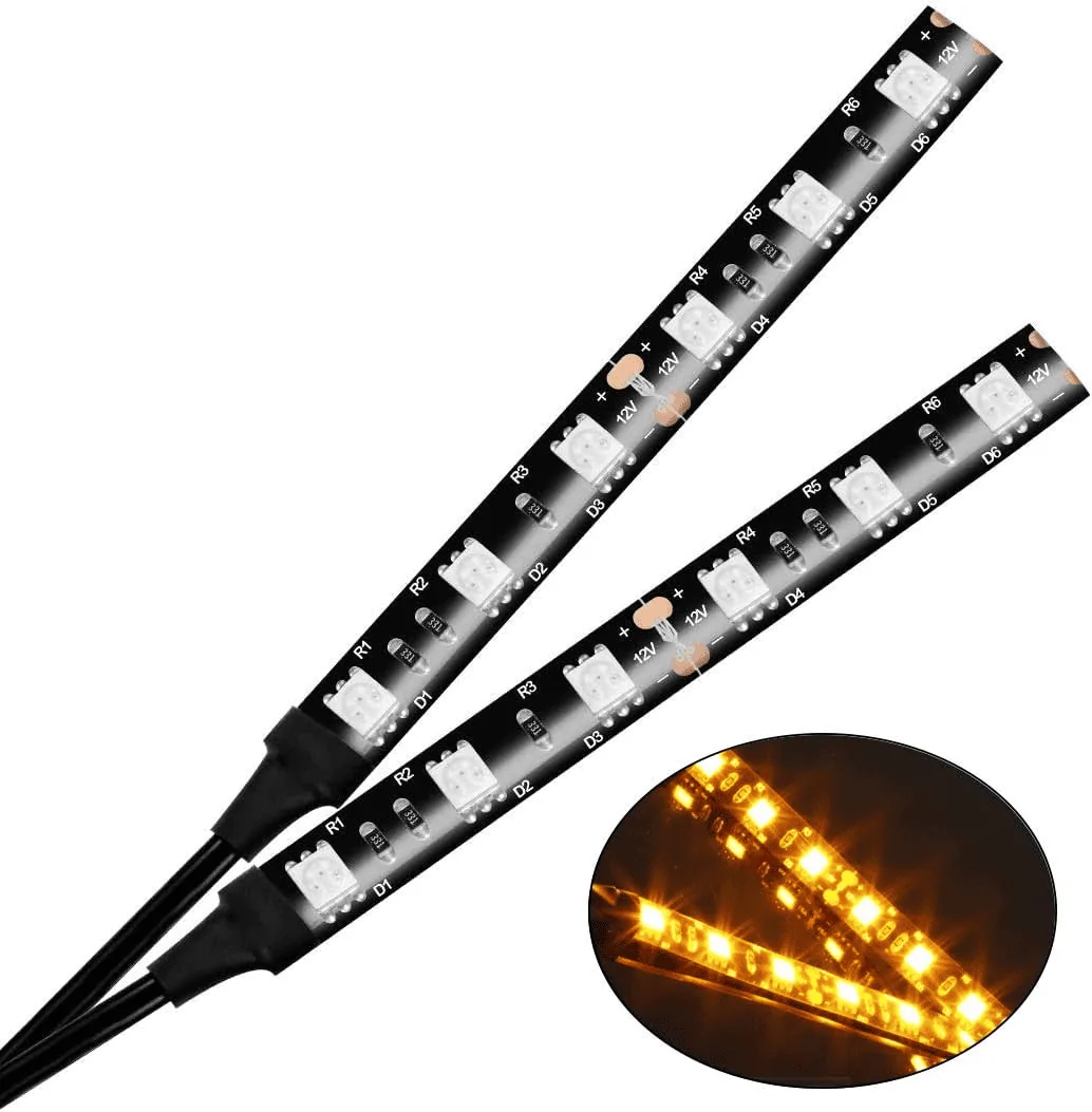

this is what i did on mine, i got the idea from someone in the forum is a led bar connected to the turn signal here is the link .
https://www.amazon.com/dp/B01EL2CG5O?psc=1&ref=ppx_yo2ov_dt_b_product_details
These have been out of stock, so I am trying these here probably cut in half to fit that area.
https://www.amazon.com/dp/B07QLPFZSD
Cheap enough to try, but it will only be 3 amber LEDs since they are spaced out a little more and you can cut them there.
What about running them vertically along the front edge. That might look good.
