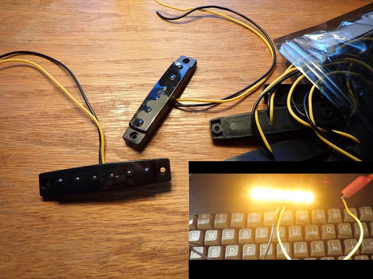

I just ordered these to try to incorporate into the side badge as turn signal indicators. Not interested in having running lights, just turn signals. I'll know more once they get here but for now I'm planning on cutting a hole in the badge and mounting them through from the back so they're almost flush:
12V Smoked Amber LED Marker Lights

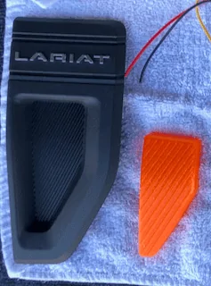

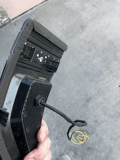

I didn't want a mile long post, so I thought I would break them up.
Here are more pictures of what I did and then I'll provide a monologue. Couldn't get the wife to film a video . . . even after I wrote a script!

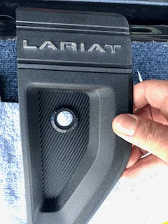

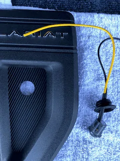

After removing the badge, I drilled a 3/4" hole in it to accommodate the round LED light I purchased from Amazon . . . about $12 for a pack of 10.
The LED has grommet that holds it snugly in place. Also waterproof. I fed the wires out the back which is why I opted for these lights as opposed to ones that had the wiring out the side.
UPDATE: After posting this, one member posted a picture of how he mounted a small lighting strip that had the wires coming out the side. He did a remarkable job hiding those wires. Scroll down a few posts to see his work on his XLT

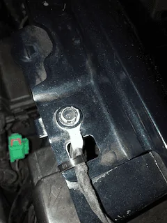

You can also see that added additional wires and taped them up. I'll need the wires separate when one goes to a grounding point and the other bridge taps into the existing turn signal at the front of the Maverick.
Next photo is my grounding point.
This is where I used a large ring terminal that included shrink wrap. I also taped it.
I've included a photo of the amber badge cover to show how well it fits. It's an option. I attached it using waterproof heavy duty dual lock tape so I can remove it for whatever reason . . . maybe the LED might need replacing.

My LEDs just arrived. Perfect. Black when off. Should fit the side badge just fine and make great turn signal indicators.
Ford Maverick 💡 Converting the Maverick side badge to a signal lamp light -- DIY how-to and result video [night video added] Image1

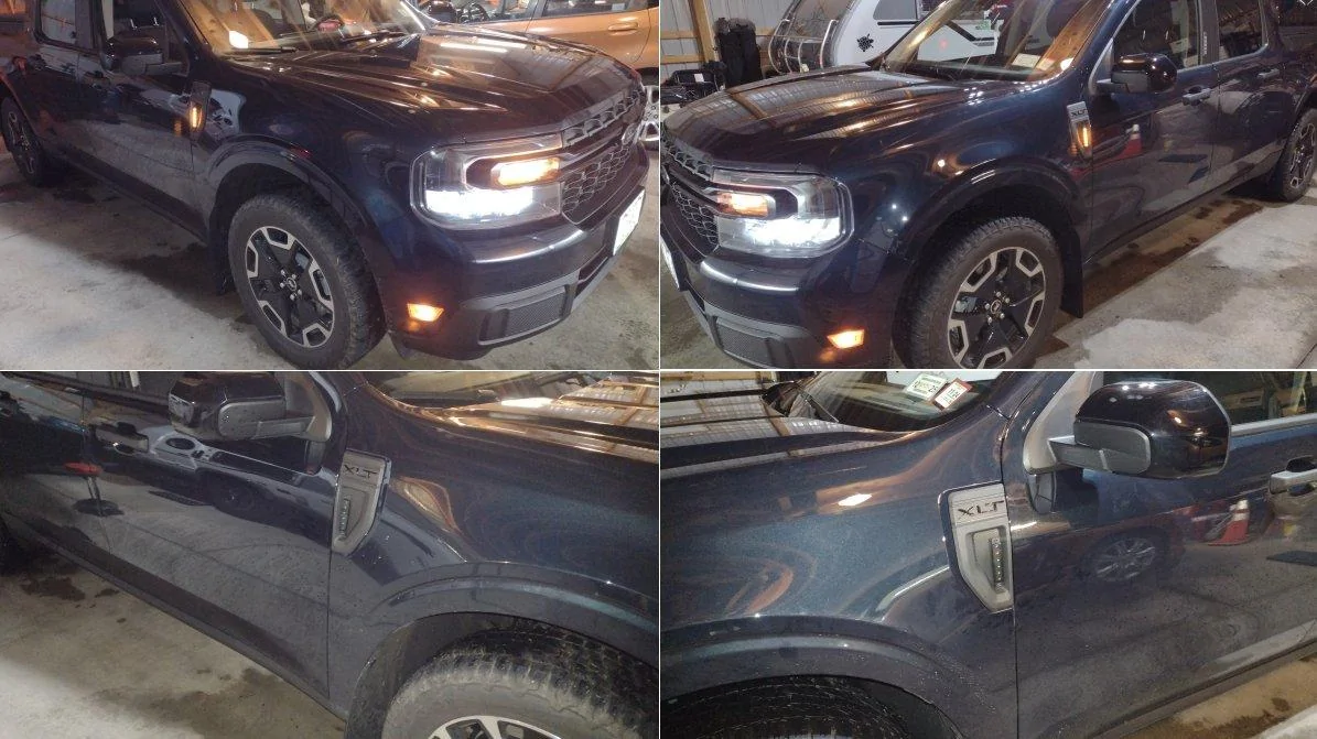

These work and are brighter that the pictures. Was going to cut and mount them from the back but more work removing the badges than I wanted. These are blacked out will work until someone comes out with a pair of lit badges a reasonable cost. I can't beat the cost at $10.99 for ten.
Smoked Amber Marker Lights
Ford Maverick 💡 Converting the Maverick side badge to a signal lamp light -- DIY how-to and result video [night video added] side turns
