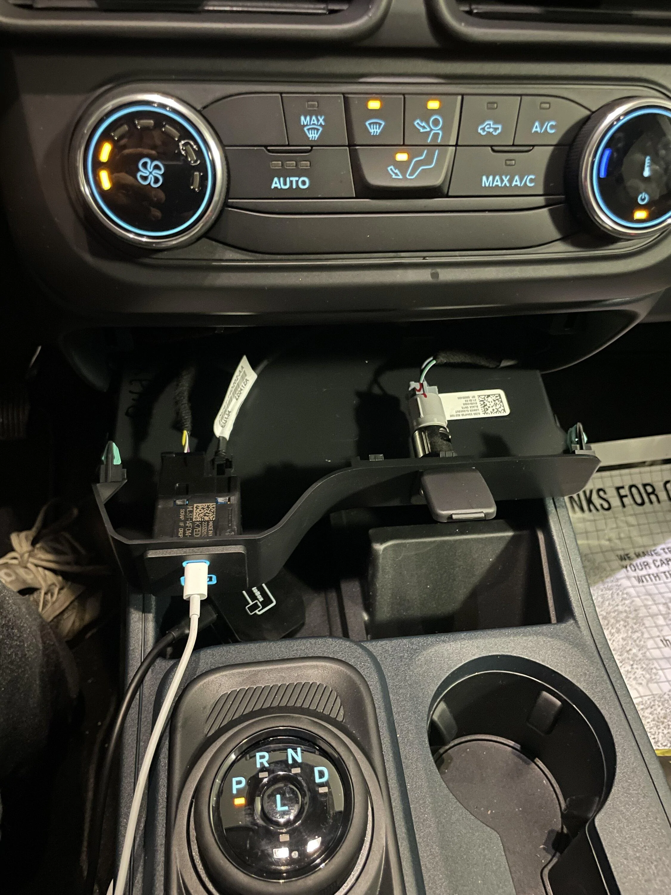

Step 1:
Remove trim, stick your finger in the cigarette lighter hole, and pull out and down, left hand by USB port.

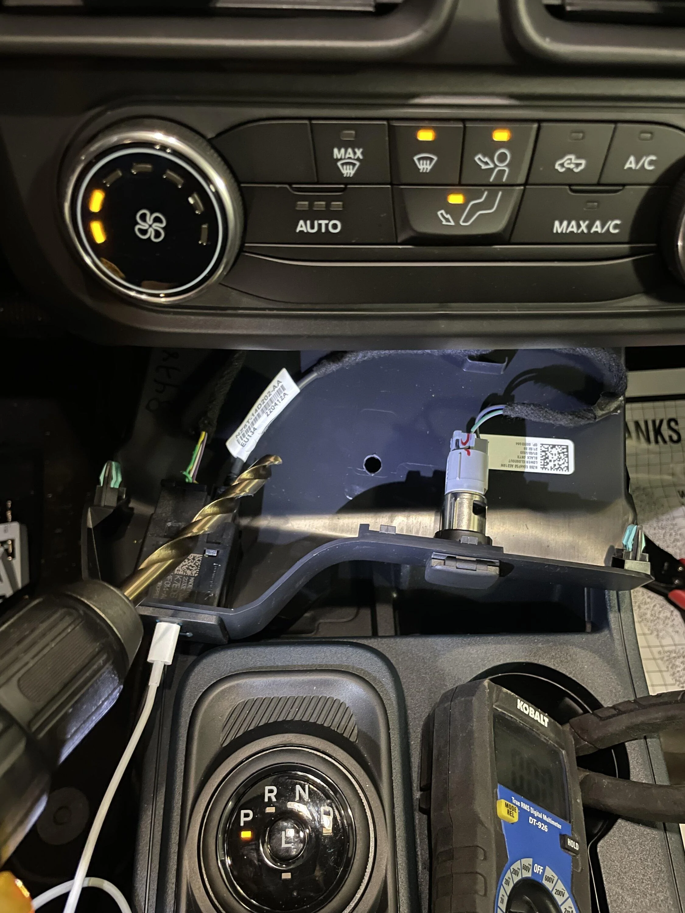

Step 2:
Drill hole for your light ( see pics for the light I used)

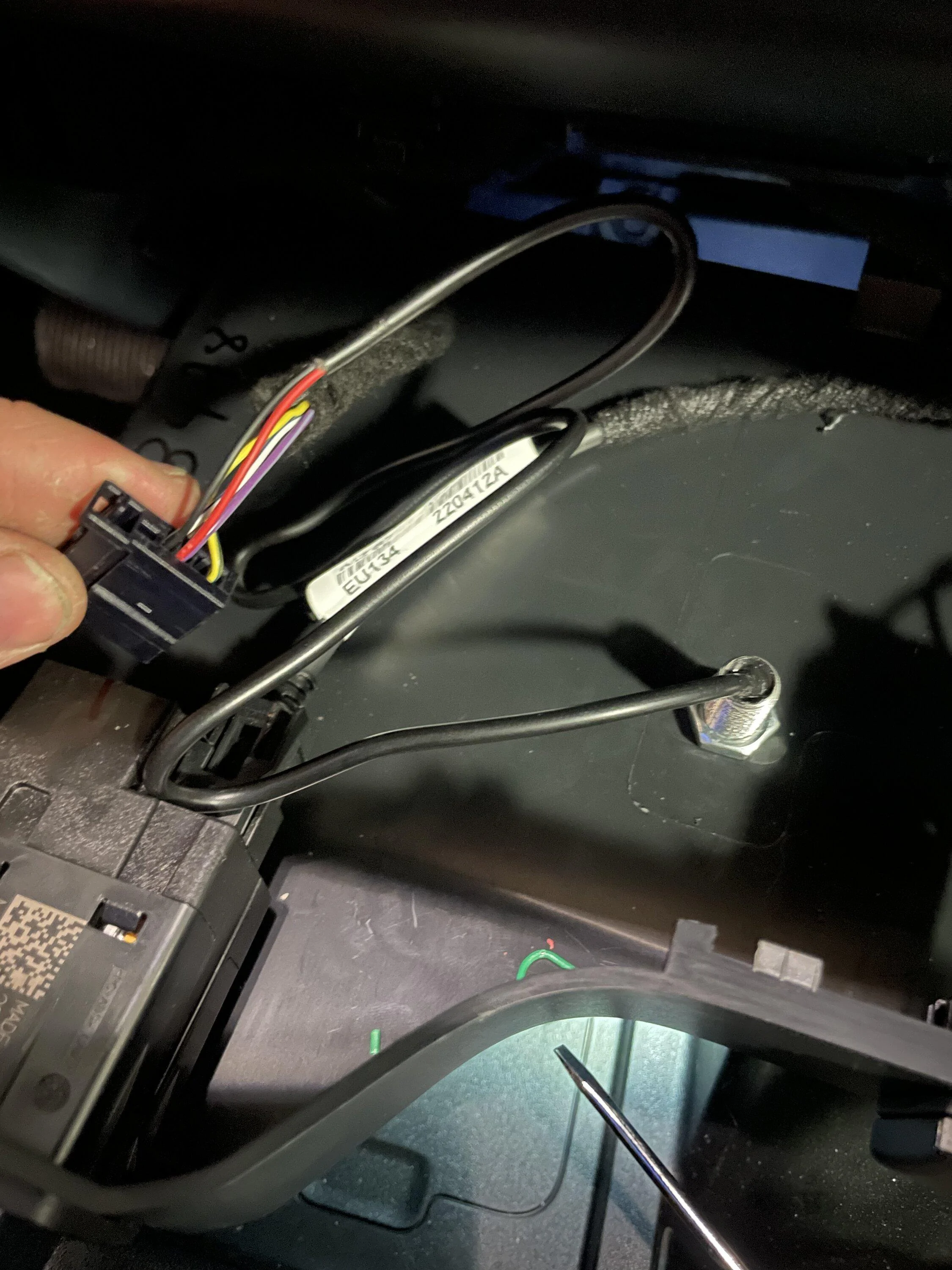

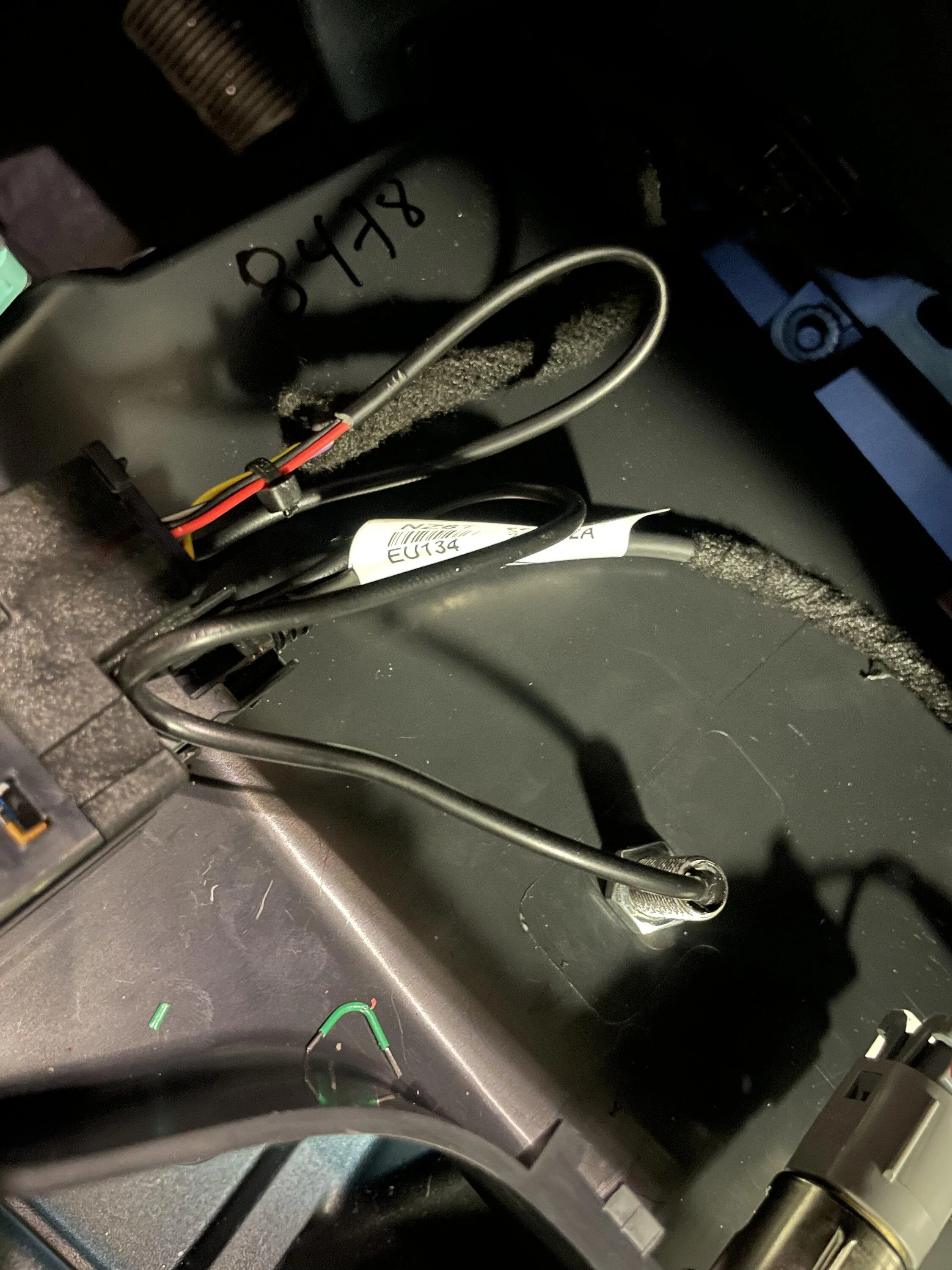

Step 3:
strip wires, jam negative in far left white with blue stripe, jam red in the purple next to it, zip tie to secure. No cutting, no splicing, no modifications to any truck wiring whatsoever. This is tapping power used by the LED that surrounds the USB ports, and it will dim accordingly.
Ford Maverick ‘OEM’ style ambient light install, - dims just like factory FC5ECAC6-56BF-4661-8481-8FDF0C67B614
Ford Maverick ‘OEM’ style ambient light install, - dims just like factory F65B3463-C34E-423A-B2E9-06E2C3E035B5

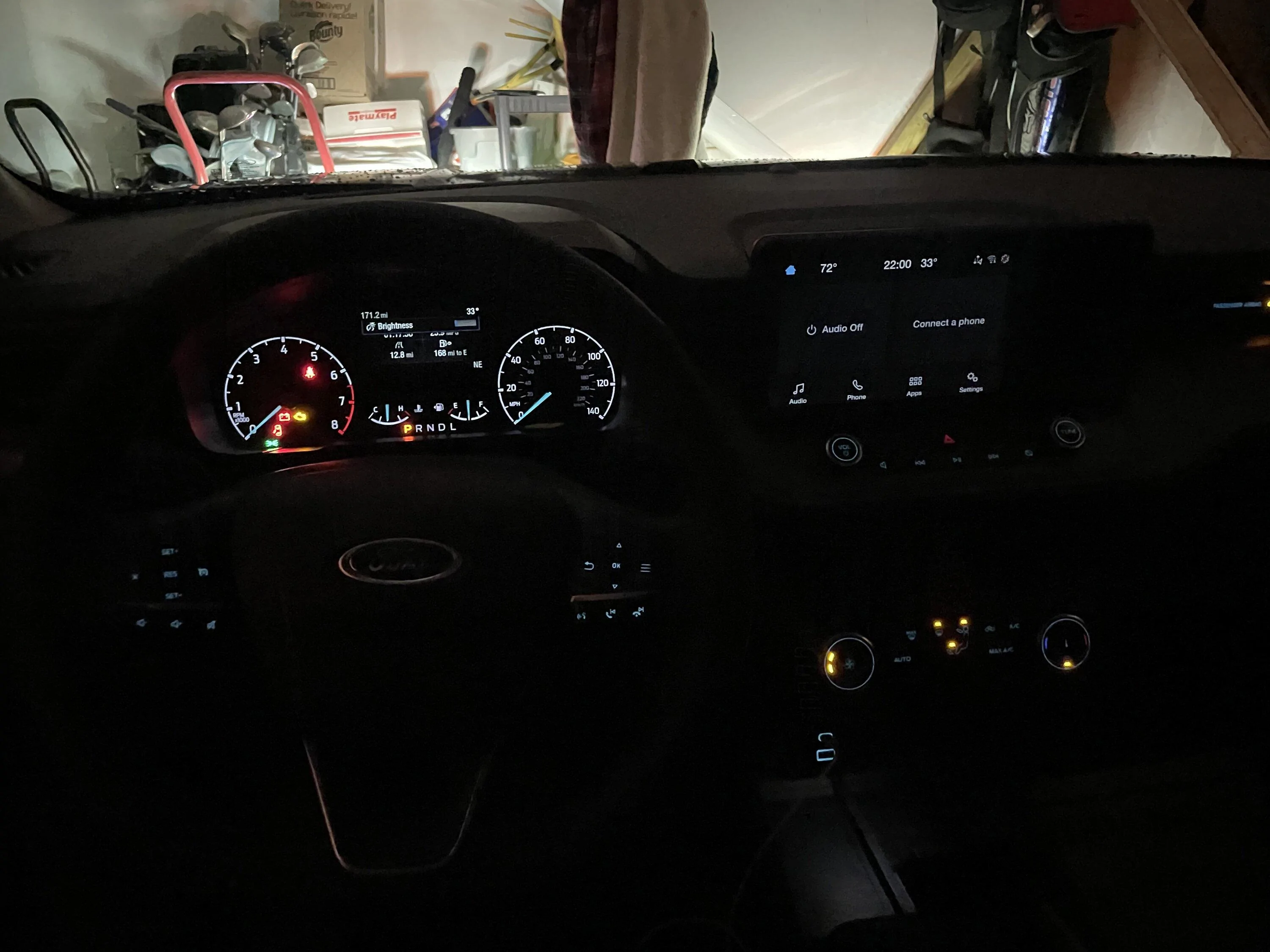

Step 4:
Reinstall trim, be sure light works as you want.

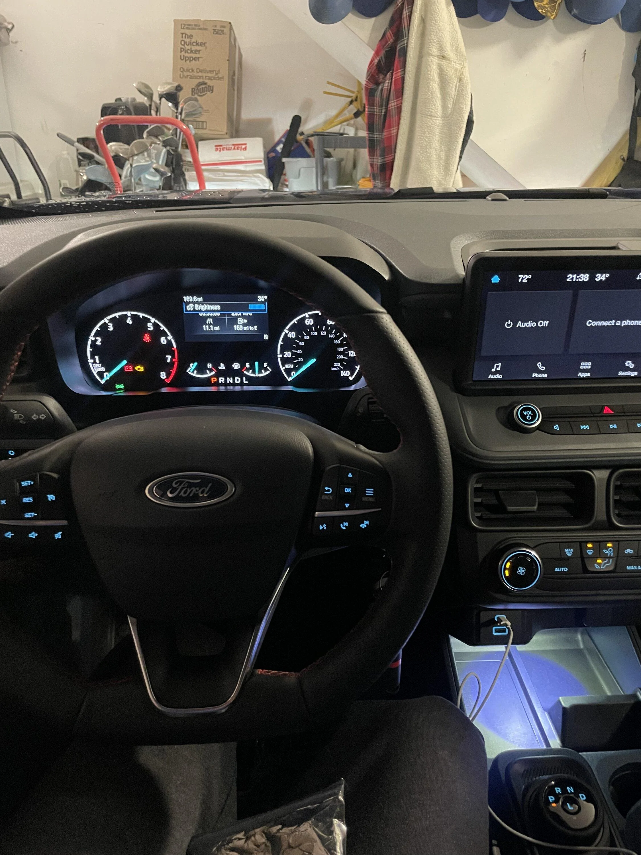

Step 5:

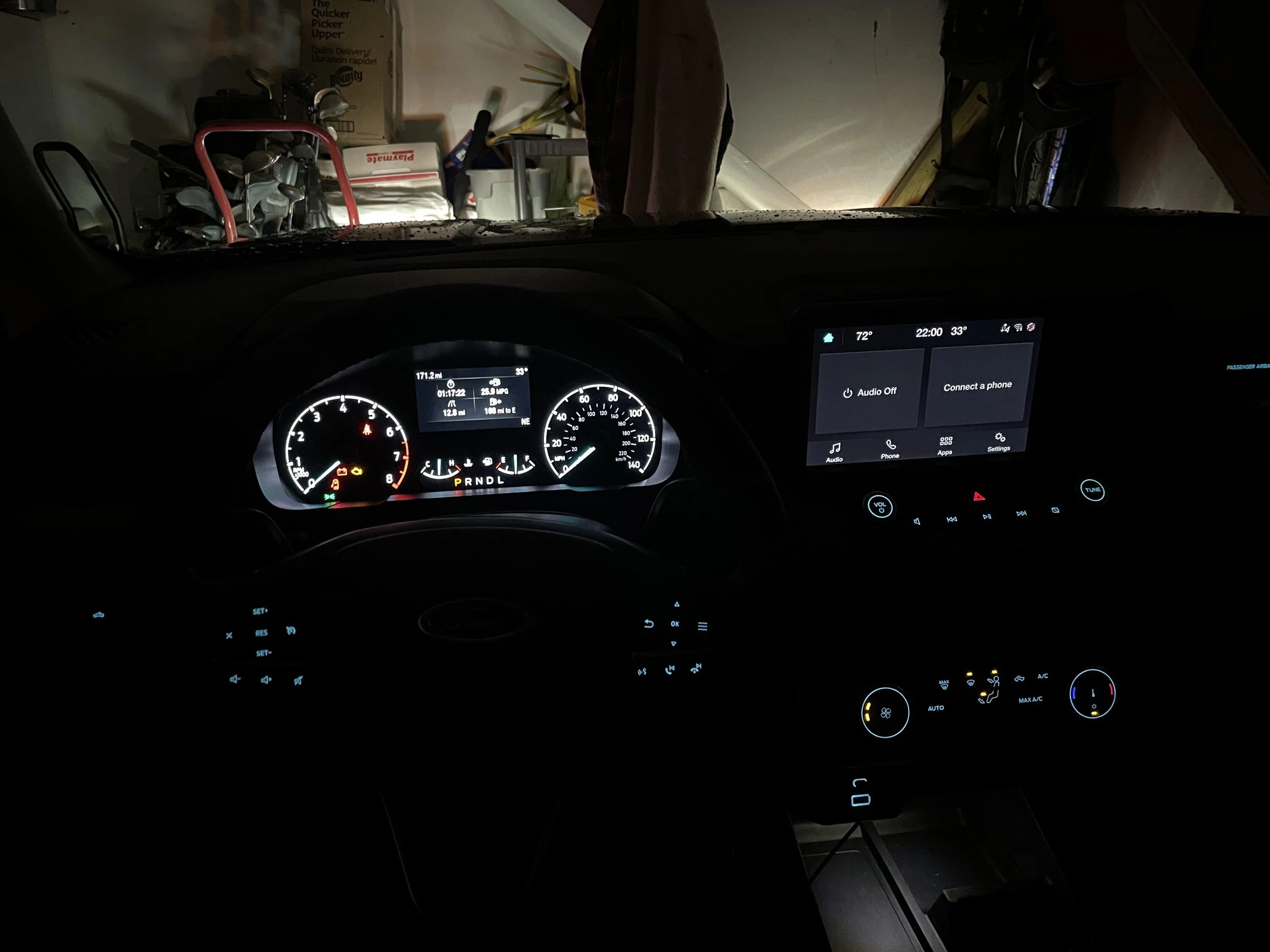

I thought it was a little too bright, I covered the light with a small square of tint. Perfect
Ford Maverick ‘OEM’ style ambient light install, - dims just like factory DACD299D-292E-4F86-B41B-39AEFD40EA37
Ford Maverick ‘OEM’ style ambient light install, - dims just like factory 9C7AD61D-2BE9-4E30-863E-56B32C8400DA
I’m very happy with it, for a few dollars it’s something I was a little bummed coming from a 22’ XL with the light, and my 23’ XLT not having it. Do at your own risk 👍
